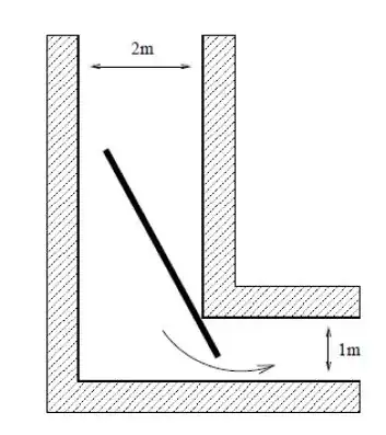

The question:
I'm given the figure shown above, and need to calculate the length of the longest rod that can fit inside this figure and rotate the corner.
My thoughts: I have tried doing the following : put $(0,0)$ at the bottom left corner. This way, the place where the rod touches the upper block is $(2,1) $ , and if we denote by $(2+t,0)$ the place where the rod touches the lower block, we get that the place where it touches the lower block is $y=t+2 $ , and then, the length is $d=\sqrt{2}(t+2)$ which doesn't have a maximum.
What am I doing wrong ?
THe final answer should be $ \sqrt{(1+\sqrt[3]{4} ) ^2 + (2+\sqrt[3]{2})^2 } $ .
Thanks !

$y = 2+\frac{2}{x-1}$
$ L = \sqrt{x^2 + (2+\frac{2}{x-1})^2}$
Take the derivative of the function inside the square root and equate it to 0
$\frac{dL}{dx} = (x-1)^{3} - 4 = 0$
$x=4^{1/3} + 1$
Thus $L = \sqrt{(4^{1/3} + 1)^2 + (2+2^{1/3})^2}$
Satish Ramanathan
  • 12,424
  • 20
  • 29
Hm, your mistake is citing wrong question. You missed the most important condition: The rod CAN PASS through the that corner.
The answer for this problem should be like: i) We observe that: Denote A is a point on the left wall of block , B is a point on the lower wall of block and AB pass through the (2;1). Then point then if min(AB) >= length of rod then the rod may pass the cornet. ii) The rest is similar to your, denote the lower point is (2+t;0) .Second, find the upper point A .Finally, find the minimum value of AB.
Your mistake is in the assertion that "the place where it touches the lower block is $y=t+2$." If you draw a picture and label the lengths of the sides of the appropriate right triangles, you'll see that in fact it touches the lower block at $y=1+{2\over t}$. This gives $(2+t)^2+(1+{2\over t})^2$ as the expression for the square of the length of the pipe. Differentiated appropriately, it has a minimum at $t=\sqrt[3]2$, and the rest should follow.
Barry Cipra
  • 81,321
Let's say the rod makes an angle $\theta$ with the long wall. Let's say the wide area has width $W$ and the narrow area has width $N$. Then, the length of the rod that can fit in at angle $\theta$ is
$$x = \frac{W}{\sin \theta} + \frac{N}{\cos \theta} = W \csc \theta + N \sec \theta.$$
There's a minimum in there at some $\theta$:
$$\frac{dx}{d \theta} = N \sec \theta \tan \theta - W \csc \theta \cot \theta = 0.$$
This simplifies to
$$\tan^3 \theta = W/N = 2.$$
Now if $\tan \theta = \sqrt[3]{2},$
$$\cos \theta = \frac{1}{\sqrt{1 + \sqrt[3]{4}}}; \sin \theta = \frac{\sqrt[3]{2}}{\sqrt{1 + \sqrt[3]{4}}},$$
