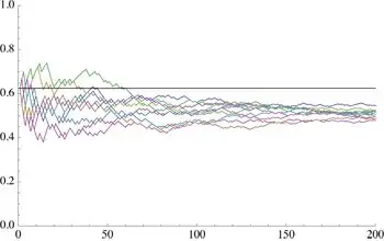

A paper by Medina and Zeilberger (arXiv:0907.0032v2 [math.PR]) says that it is an unsolved problem to determine if it is better to continue or stop after you have flipped 5 heads in 8 trials: accept \$62.50 or hope for more. It is easy to simulate this problem and it is clear from even limited experimental data that it is better to continue (perhaps more than 70% chance you'll improve over \$62.50):
alt text
My question is basically: Why is this difficult to prove? Presumably it is not that difficult to write out an expression for the expectation of exceeding 5/8 in terms of the cumulative binomial distribution.
