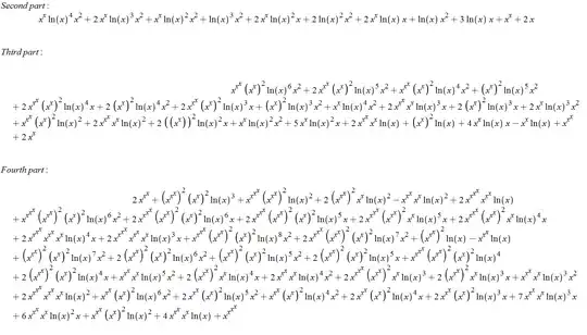

I am trying to find a general derivative for the function: $f(x)=x^{x^{x^{...^{x}}}}$however to do that I must find $f^{\prime }$ and $f^{\prime \prime}$...etc. I am now trying to write down a general expression for $f^{\prime \prime}$ and I have stumble opon the series in the picture below, I wonder, do anyone have an idea of what sort of expantion it migth be ? I have tried breaking it down into three different sums, but I wasn't very successful!
EDIT
So since this post has gotten some attention and the title has been change I will tell you what I am on about, although I already have a post just for the question in the title from before. I am as I said earlier trying to find a general derivative for the function $f(x)=x^{x^{x^{...^{x}}}}$ where $n$ is an arbitrary number, natural number and greater or equal to 2. I have already made success when I tried to find the first derivative, and I have also found some interesting pattern emerge when the derivatives as well as n incresses. But my question here was if anyone knew what this expation might be or look similar to be, since I have yet to be lernt series etc. I did not know that the question needed such background since it's straight a forward question.

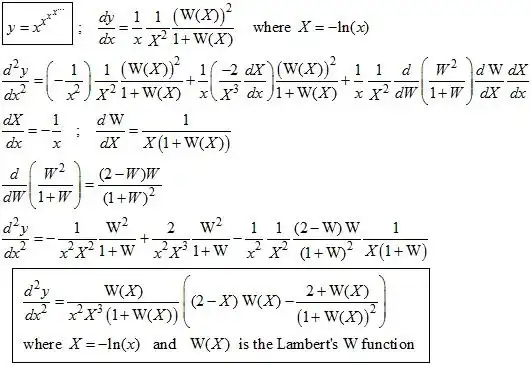

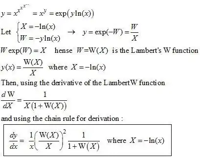

In case of the infinite tower powers, the dérivatives can be expressed on closed form thanks to the Lambert's W function : http://mathworld.wolfram.com/LambertW-Function.html enter image description here
The second derivative is obtained thanks to the chain rule : enter image description here
