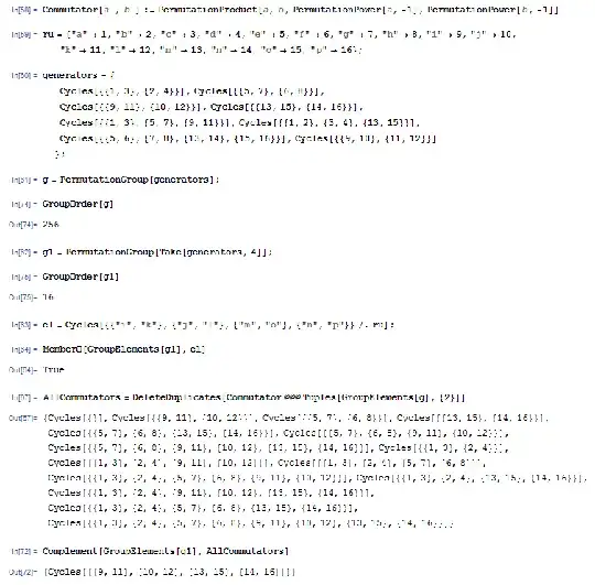

I am not sure if this is a good enough of a proof for you, but I can work it out in Mathematica and confirm that with explicit computations. If this not helpful, I would be happy to delete the answer.
Mathematica session snapshot
The copy and paste ready code follows:
Commutator[a_, b_] :=
 PermutationProduct[a, b, PermutationPower[a, -1],
  PermutationPower[b, -1]]
ru = {"a" -> 1, "b" -> 2, "c" -> 3, "d" -> 4, "e" -> 5, "f" -> 6,
   "g" -> 7, "h" -> 8, "i" -> 9, "j" -> 10, "k" -> 11, "l" -> 12,
   "m" -> 13, "n" -> 14, "o" -> 15, "p" -> 16};
generators = {
   Cycles[{{1, 3}, {2, 4}}], Cycles[{{5, 7}, {6, 8}}],
   Cycles[{{9, 11}, {10, 12}}], Cycles[{{13, 15}, {14, 16}}],
   Cycles[{{1, 3}, {5, 7}, {9, 11}}],
   Cycles[{{1, 2}, {3, 4}, {13, 15}}],
   Cycles[{{5, 6}, {7, 8}, {13, 14}, {15, 16}}],
   Cycles[{{9, 10}, {11, 12}}]
g = PermutationGroup[generators];
GroupOrder[g]
g1 = PermutationGroup[Take[generators, 4]];
GroupOrder[g1]
el = Cycles[{{9, 11}, {10, 12}, {13, 15}, {14, 16}}];
MemberQ[GroupElements[g1], el]
AllCommutators =
 DeleteDuplicates[Commutator @@@ Tuples[GroupElements[g], {2}]]
Complement[GroupElements[g1], AllCommutators]
