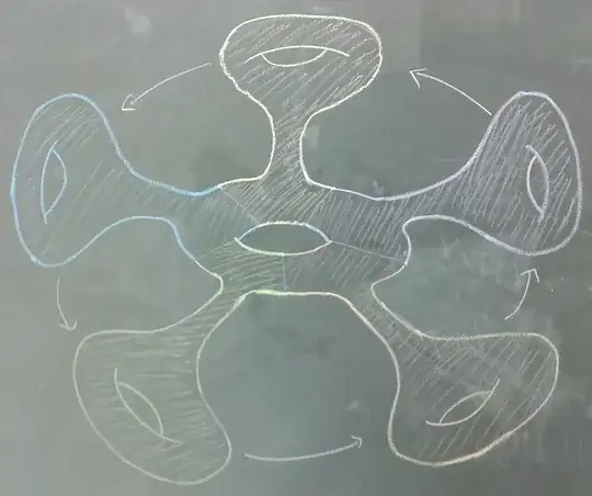

You are correct that there is a degree five covering map $\Sigma_6 \to \Sigma_2$. One way to view this covering map is to think of $\Sigma_6$ as in the following (poorly drawn) picture:
The arrows indicate a map which generates the group of deck transformations (which is isomorphic to $\mathbb{Z}_5$). The five regions are fundamental domains for the action of the deck transformations. After quotienting $\Sigma_6$ by this action, we have identified all of these regions with each other (so we can pretend we just have one), and we identify the two boundary components of this region which leaves us with a surface of genus two.
More generally, if $\chi(\Sigma_g) = k\chi(\Sigma_h)$, then $g = 1 + k(h - 1)$, so we can view $\Sigma_g$ with $k$ equally spaced chains of $\Sigma_{h-1}$ attached to a single torus, then the group $\mathbb{Z}_k$ acts by rotations and the quotient is $\Sigma_h$. In particular,
