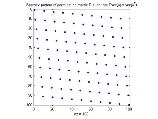

The commutation matrix $P$ is uniquely defined by the above relation, but it also has a simple construction as follows. Let $Y$ be the matrix of the same size as $X$, but with value $k$ at the $k$'th linear index - $\mathrm{vec}(Y) = (1,2,3,4,5,6,\dots,nm)^T$. For example in the 4-by-5 case we have, $$Y = \begin{bmatrix} 1 & 5 & 9 & 13 & 17 \\ 2 & 6 & 10 & 14 & 18\\ 3 & 7 & 11 & 15 & 19\\ 4 & 8 & 12 & 16 & 20 \end{bmatrix}.$$ Then $P$ is the permutation matrix where the $1$ in the $i$'th row is in the column given by the $i'th$ entry of $\mathrm{vec}(Y^T)$. Ie, $$P_{ij} = \begin{cases} 1, \quad j \mathrm{~is~the~}i'th\mathrm{~entry~of~}\mathrm{vec}(Y^T), \\ 0, \quad \mathrm{else} \end{cases}$$ In picture form, it looks like this: Commutation operator
