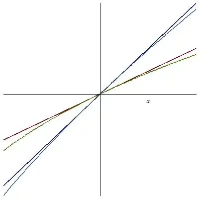

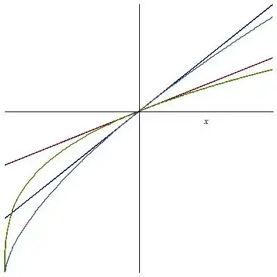

This is Joe's answer and Michael's answer but with pictures! Also this answer is for intuition not rigour.
We start with functions $y=f(x)$ and $y=g(x)$ that are differentiable and have roots at $x=a$. Something like (maybe $f(x)$ blue and $g(x)$ red)
Now as Michael says, when we zoom in on differentiable functions they look like lines --- near a point, functions are well-approximated by their tangents. How good is this approximation: doesn't matter here really!
So we draw the tangents:

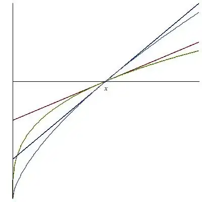

Now $f(x)$ is light blue and $T_f$ is light blue. Also $g(x)$ is green and $T_g$ is red. At this point we could zoom in or we could follow Joe's argument. Instead I am going to translate everything to the origin!
In terms of your limit you can do this via $z=x-a$:
$$\lim_{x\rightarrow a}\frac{f(x)}{g(x)}=\lim_{z\rightarrow 0}\frac{f(z)}{g(z)}:$$

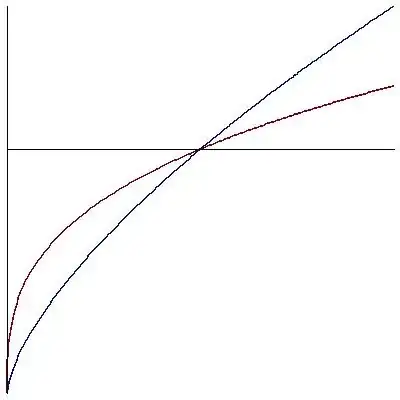

This should be a $z$-axis
Now zoom in (This should be a $z$-axis)... and of course $T_f(z)=f'(a)z$ and $T_g(z)=g'(a)z$ (where the derivatives are respect to $x$):
Now you have:
$$\frac{f(x)}{g(x)}=\frac{f(z)}{g(z)}\approx \frac{f'(a)z}{g'(a)z}=\frac{f'(a)}{g'(a)},$$
near $z=0\Leftrightarrow x=a$.
Maybe the translation is unnecessary if we write $T_f(x)=f'(a)(x-a)$ and $T_g(x)=g'(a)(x-a)$.
