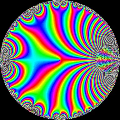

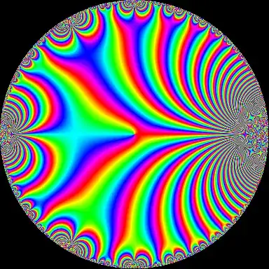

Assuming that math formulae hold numerically, and then getting confronted with cancellations of significant digits. For the sake of its strange regularity, I'd like to present an example produced by my own naivity.
Fig. (a) below shows a phase plot of the (normalized) modular discriminant $$\Delta(q) = q\prod_{n=1}^\infty(1-q^n)^{24}\quad\text{for}\quad |q|<1$$ over $q$ in the complex unit disk. You will notice Moiré effects, but these are not the artefacts I am going to discuss here.
Note that $\Delta(q^2)$ can be expressed in terms of Jacobi Thetanull functions: $$\Delta(q^2) = 2^{-8} \vartheta_2^8(q)\,\vartheta_3^8(q)\,\vartheta_4^8(q)$$ These are related by Jacobi's Vierergleichung $$\vartheta_3^4(q) = \vartheta_2^4(q) + \vartheta_4^4(q)$$ The silly idea was to use the Vierergleichung to eliminate $\vartheta_4^4(q)$, giving $$\Delta(q^2) = \left(2^{-4} \vartheta_2^4(q)\,\vartheta_3^4(q) \left(\vartheta_3^4(q)-\vartheta_2^4(q)\right)\right)^2\tag{*}$$
Problem is that as $q\to1$, the Thetanull $\vartheta_4(q)\to0$ whereas the other two Thetanulls grow unbounded. Thus (*) uses an ever-smaller difference of two ever-larger complex values and soon looses all numeric accuracy. The result, computed with IEEE-754 double precision arithmetic, is shown in Fig. (b) below. Some of the artefact's features can be easily understood, others are still a mystery to me. Larger resolutions are available on request.
(a) Phase plot of $\Delta(q)$ as it should be (b) Phase plot with artefact
ccorn
