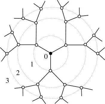

Percolation on Cayley trees (Bethe lattice)
credit: wikipedia
Every site has exactly $z$ neighbours in this type of lattice. The above is the Cayley tree for $z=3$

The 2 above lattices are amendable to an exact analytical solution because a walker on such grid can never loop back. Building on this observation, we can easily see that for a 1-d lattice of $L$ sites, the probability that a spanning cluster path exists is $P^L$. For the Bethe lattice, the question is already not as clear cut because one has to specify how it is cut.
This illustrates just how hard of a problem it is. Say there is no further site on the above image. We have to compute everything explicitly. Possible path could consist of going from level 3 to level 2 back to level 3 immediately. One could also go down as far as level 1 and backup, or through the central node. The problem is already somehow ill defined.
