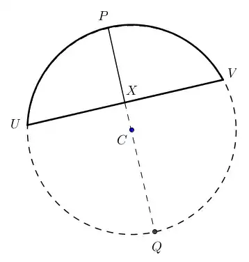

We can apply the Intersecting Chords Theorem.
You chord length is the length $UV$ and the segment height is the length $PX$.
The intersecting chords theorem tells us that $XP \times XQ = XU \times XV$.
Let $\ell = UV$ and $h=XP$. It follows that $UX = XV = \tfrac{1}{2}\ell$. The ICT then tells us that
$$\tfrac{1}{2}\ell \times \tfrac{1}{2}\ell = h \times XQ \, ,$$ i.e. $XQ = \tfrac{1}{4h}\ell^2$. The diameter $PQ=PX+XQ$ and $$PX + XQ = h + \frac{\ell^2}{4h}=\frac{4h^2+\ell^2}{4h}$$
The radius is then one half of this, i.e.
$$CQ = \frac{4h^2+\ell^2}{8h} \, . $$

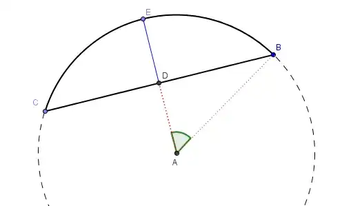

Here is the solution using trigonometry
pic
Consider given the height $h=DE$ and the half length $a=DB$. The triangle ADB produces the following two equations
$$ a = r \sin \theta \\ r-h = r \cos \theta $$
where $r$ is the unknown radius, and $\theta$ is the included half angle (denoted on point A above)
If these two equations are squared and added together they make
$$ a^2 + (r-h)^2 = (r \sin\theta)^2 + (r \cos \theta)^2 = r^2 $$
The solution to this is $$ \boxed{ r = \dfrac{a^2+h^2}{2 h} } $$

This problem can be solved as follows. There are two knowns and two unknowns. The two knowns are the chord length $UV$ ($l$) and the chord height $XP$ ($h$). The two unknowns are the radius ($PC$ or $r$) and $XC$ which is part of the radius. Lets call this $q$. I used the drawing and symbols from the first answer to the problem.
We can write two distinct equations using the two knowns and two unknowns, so we can solve this problem:
(1) $h + q = r$
(2) Using the Pythagorean theorem, $(\frac{l}{2})^2 + q^2 = r^2$. To see this draw a line from $C$ to $V$ (this distance is $r$ of course). Since $PC$ bisects $UV$, the angle $CXV$ must be a right angle, so the Pythagorean theorem applies
By rearranging (1) as $q = r - h$, substitute $r - h$ for $q$ in equation (2)
Without going through all the math, you can solve equation (2) for $r$
The solution is: $$r = \dfrac{\left(\frac{l}{2}\right)^2 + h^2}{2h}$$
or
$$r = \dfrac{\frac{l^2}{4} + h^2}{2h}$$
Multiply numerator and denominator by $4$ and you get the same answer as previously submitted
