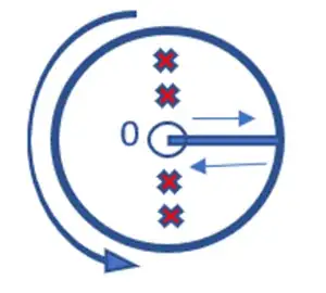

To evaluate the integrals let's consider the following contour: along the cut from $0$ to ${\infty}$ (along the $X$ axis), big circle of radius $R$ (counter clockwise), along the other bank of the cut back to $0$ and along a small circle $r$ around $0$ (around a brunch point of $t^q$ - $q$ is rational) to the starting point.
Making a full round in the positive direction, on the lower bank of the cut the integrand gets additional factor $e^{2\pi{iq}}$. Integral along this closed contour is equal to the sum of residuals in simple poles, and integrals along big and small circle set to zero as $R\to\infty$ and $r\to0$. So, $$I(k,q)(1-e^{2\pi{iq}})=2\pi{i}\frac{k!}{\Gamma(q)}\sum{Res}\frac{t^{q-2}}{(t^2+2^2)(t^2+4^2)...(t^2+k^2)}, k=2n$$ $$I(k,q)(1-e^{2\pi{iq}})=2\pi{i}\frac{k!}{\Gamma(q)}\sum{Res}\frac{t^{q-1}}{(t^2+1^2)(t^2+3^2)...(t^2+k^2)}, k=2n-1$$ Finally, for even ($k=2n$), $q>1$ ($q$ - rational); $a=2, b=4, ...=k$ $$I(k,q)=\frac{-\pi{k!}}{2\Gamma(q)\cos\frac{\pi{q}}{2}}\left(\frac{a^{q-3}}{(b^2-a^2)(c^2-a^2)..(k^2-a^2)}+\frac{b^{q-3}}{(a^2-b^2)(c^2-b^2)..(k^2-b^2)}+..\right)$$ Or, after slight further simplification, $$I(k,q)=\frac{-\pi{k!}2^{q-2n-2}}{\Gamma(q)\cos\frac{\pi{q}}{2}}\left(\frac{a^{q-3}}{(b^2-a^2)(c^2-a^2)..((\frac{k}{2})^2-a^2)}+\frac{b^{q-3}}{(a^2-b^2)(c^2-b^2)..((\frac{k}{2})^2-b^2)}+..\right)$$ where $a=1, b=2, c=3…=\frac{k}{2}(=n)$
