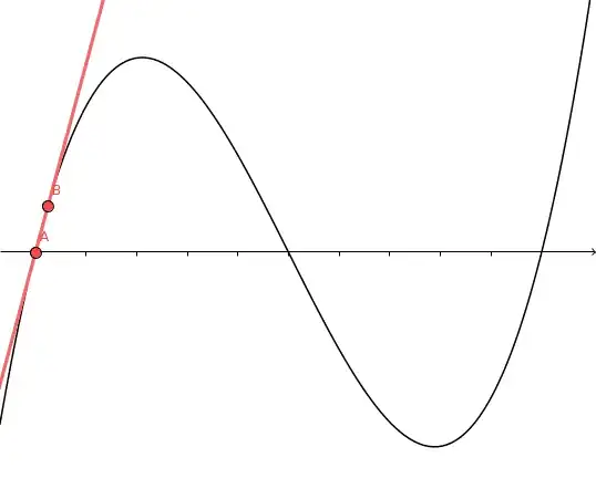

A proof without words:
The slope of the secant varies continuously from $f'(a)$ to $f'(b)$, so takes on every value in $[f'(a), f'(b)]$. By the mean value theorem, so does $f'$.
For the details, you can read the original proof by Lars Olsen that this animation is based on. Remarkably, this proof only seems to have been discovered in 2004.
