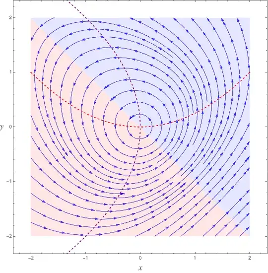

The sole critical point is the origin.

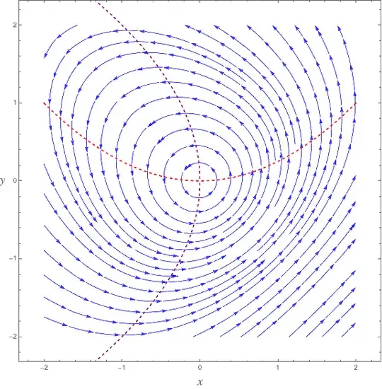

Phase portrait
The nullclines are the dashed lines. Red for $\dot{x} = 0$, purple for $\dot{y} = 0$.
flow
Analysis

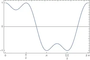

Polar coordinate transformation produces $$ \dot{r} = r^{2} \left( \cos^{3} \theta + \sin^{3} \theta \right) $$ The plot following shows $$ f(\theta) = \cos^{3} \theta + \sin^{3} \theta $$
theta
The red zone shows contraction where $\color{red}{\dot{r} < 0}$, and the blue zone dilation, $\color{blue}{\dot{r} > 0}$
two face
Notice that as we approach the origin, the dynamical system $$ % \begin{align} % \dot{x} &= -4y + x^{2} \qquad \Rightarrow \qquad -4y\\ % \dot{y} &= 4x + y^{2} \qquad \Rightarrow \qquad 4x % \end{align} % $$ approaches a periodic system.

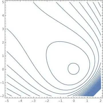

$$ 36 c_1 \left(x_1-x_2\right)-4 \left(36 c_1+2^{2/3} x_2\right)+2^{2/3} x_1 \left(x_2+4\right)+ 2^{2/3+2} \left(4-x_1+x_2\right) \ln \left(\left(x_1-4\right) x_1+16\right)+2^{2/3+3} \left(x_1-x_2-4\right) \tanh ^{-1}\left(\frac{\left(x_1-8\right) x_1+4 \left(x_2+8\right)}{x_1^2-4 x_2}\right)=0 $$
and we can obtain a level set partition as shown in the following plot
typical of a conservative system.
