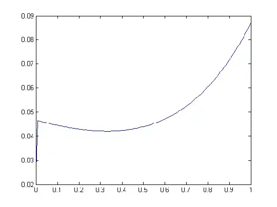

I have problems with a solution of an integral equation in MATLAB: all conditions are double-checked, but the answer is incorrect. Let me state the equation: $$ x(s) = g(s)+\int\limits_0^1x(t)f(t-s)\,dt\quad(1) $$ where $$ f(t) = \frac{\sqrt{2}}{\pi(1+(t+1)^4)} $$ and $$ g(s) = \int\limits_{1-s}^\infty f(t)\,dt. $$ For the solution $x$ I know that it should be bounded $0\leq x(s)\leq 1$ and monotonically increasing. To solve this equation I used fie toolbox which is also supported by many publications of K. Atkinson and provides strict bounds on the error. The graph of the solution: fie
Note an ugly jump close to $0$ as well as non-monotonic behavior of the function. An error said to be less than $10^{-4}$.

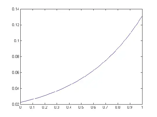

This result didn't satisfied me and I then found $x$ with a naive approach: made a grid on $[0,1]$ with a step $10^{-3}$ and replaced $x(s)$ by $x_i = x(s_i)$, $g(s)$ by $g_i = g(s_i)$, $f(t-s)$ by $f_{ij} = f(s_j-s_i)$ and integral by a sum. As a result I obtained $(\mathbf I - \delta \mathbf f)\mathbf w = \mathbf g$. Solution of this system is on this picture. With this method an error is less than $0.01$.
Naive solution
I used fie toolbox for the problem which is much tough and the result was perfect, but for the current equation something goes wrong. I hope that it's due to the fact I've encoded something incorrect.
I spent already three days trying to find a mistake - but there is no so much code and I wonder if you can help me. Maybe, it will be better if I put the code here for someone to help me check it? In the case this question is off-top, I am sorry - just tell me, I'll delete it.
