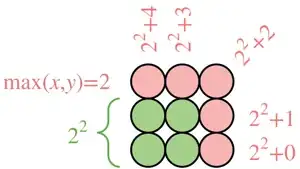

Another unique key for non-negative integer pairs is
$$\mathrm{key}(x,y)=\max(x,y)^2+\max(y,2y-x)$$
This covers squares first, so should meet your conditions as well as not being limited to a given argument maximum. That is, if $\max(x,y)\lt2^n$, then $\mathrm{key}(x,y)\lt2^{2n}$.
$\hspace{4cm}$enter image description here
