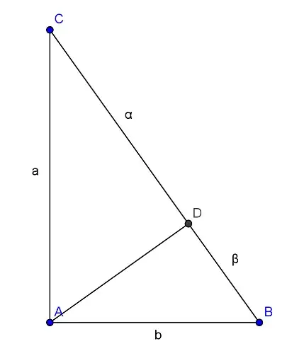

There is a proof using Similar Triangles:
We get from $\triangle CDA$ and $\triangle ABC$ that $\displaystyle \frac{CD}{AC} = \frac{CA}{BC}$ i.e. $\displaystyle \frac{\alpha}{a} = \frac{a}{c}$ i.e. $ \alpha c = a^2$
Similarly $\displaystyle \beta c = b^2$.
Adding gives the result.
Aryabhata
