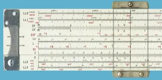

And let's not forget this method (read off of the Ln scale).
Image source
