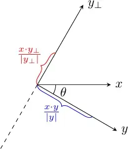

My intuitive interpretation is usually in the terms of projections, \begin{align} x \cdot y &= |x||y|\cos(\theta) \end{align} If necessary, sine can be viewer similarly, as projected towards $y_\perp$.
Projections of x
  • Can you flush this out a little more? I don't know what x and y are in this context... or the meaning of "y perpendicular" (it's probably obvious, but I'd appreciate the help, thanks.) – Noteventhetutorknows Jul 18 '11 at 23:48
  • I will have to draw a figure to. It'll take a moment. – Mikael Öhman Jul 18 '11 at 23:50
  • I think I see what you are saying now. Though, I don't see how this realtes to the differential equation, are you suggesting this as a definition of cosine that I missed? http://en.wikipedia.org/wiki/Dot_product – Noteventhetutorknows Jul 18 '11 at 23:51
  • I didn't see anything specifying interpretations only related to differential equations in your question. However, this interpretation of cosine can be usefull even when doing projections of in function spaces, as the case of fourier series or finite element. – Mikael Öhman Jul 19 '11 at 00:25
  • there are three things I'm looking for: a connection between taylor series and the unit circle, a connection between the ODE y''=-y and the unit circle, and as an aside any other important representations, I guess I ought to have made that more clear, thanks! – Noteventhetutorknows Jul 19 '11 at 00:57
  • If you se the lenghts of the vectors $x$ and $y$ to 1 and align it, you will see that these projections are exactly what you see in the unit circle. – Mikael Öhman Jul 19 '11 at 01:08
  • I see the connection to the unit circle, but I'm still looking for the bridge between topics as mentioned before. – Noteventhetutorknows Jul 19 '11 at 01:13
