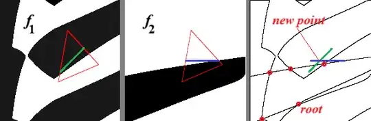

Here is an example to get the idea. Values of $\text{sign}(f_i)$ in black/white and the resulting line (left, mid) and their intersection (right).

  • Would you elaborate a bit on what Step 3’s ‘$f_1$ changes signs …’ means? – A rural reader Jun 21 '25 at 16:12
  • That means the signs of $f_1$ at the vertices of the triangle are not all the same, since otherwise there is no line of intersection with $z=0$. – darksun Jun 21 '25 at 17:29
