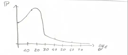

I did some research on the internet, and it seems that the onset age for those with type 1 diabetes looks like this. enter image description here
It is much more likely for the disease to develop during your infancy and adolescence, it peaks during your teens and then it drops and flattens out during adulthood. Maybe this graph is a little imprecise, I need to read more papers, but that is beside the point here.
I figure that this is the graph of the PDF whose associated random variable returns the age at which you will develop the disease, assuming you will develop the disease in the first place; besides, doesn’t this remind us of survival analysis?
However, not everyone develops the disease. The general incidence is 3%, but, in my case, since I already have a diabetic sibling, the (conditional) probability I will develop the disease is 7%.
I would like to have a curve that when integrated over an interval tells me the probability I will develop the disease. In my mind, I should simply take the previous graph, whose integral over the full domain was 1 (it is a PDF, after all) and rescale it, so that its integral is 0.07 in my case, and 0.03 for a general patient.
Is my line of reasoning correct? Does this thing have a name? It looks like a density function with all of the properties of an honest PDF, except that $\int _{-\infty} ^\infty f(x) dx \neq 1$.

    Well, this looks like a conditional probability. That is: Given that a patient does contract the disease, what is the probability that it happens in year $i$. You could divide by the total integral to make it into a standard probability. – lulu Jun 11 '25 at 11:06
    Alternatively, you could add an atom representing the case where the patient never contracts the disease. Thus, making your distribution into a mixed continuous/discrete sort of thing. But I think that viewing it as a conditional probability better captures what you are after. – lulu Jun 11 '25 at 11:12
    A curve does not have to be a PDF to convey useful information. In this case, I guess that the graph could be more useful it it'd show how much is likely that a random person develops diabetes at age $i$ given that they are alive at that age. If that's the case, it doesn't even have to add to the general incidence, since not every $i$ age is populated by the same number of people. Your interpretation, that the graph is the conditional probability given that you got sooner or later the desease, it's less useful IMO, since it's mixing also the likelihood of being alive. – nicola Jun 11 '25 at 13:52
    Consider also that rescaling to $7%$ to account family history might not be correct. Maybe also the shape of the function (whatever the interpretation of it is correct) changes: it could be that you are more likely (or less likely) to develop earlier/later the diabetes than someone with no history. – nicola Jun 11 '25 at 13:57

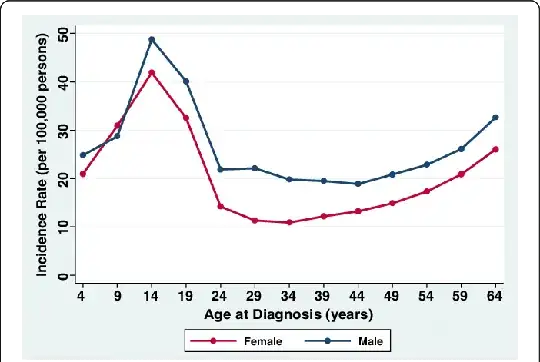

The graph you've sketched looks a little like this graph of incidence rates* :enter image description here
Assuming that this is the graph you're thinking of, it shows the number of people per year per 100,000 persons diagnosed with diabetes. (In this case for the period 2001-2015, and pooled into age categories 5 years wide.)
Not quite, though it is closely related. It is the graph showing the proportion of people of any given age and gender who will be first diagnosed with diabetes in the next year. For example, approximately 25 in every 100,000 fifty-five-year-old men will be diagnosed with diabetes.
So assuming that diagnostic criteria, treatment options, and population dynamics don't change much in the coming decades (a very dubious assumption, but I can't predict the future so I have to work with past data), then: Conditional on you reaching the age of 55 and not already being diagnosed, your odds of being diagnosed with diabetes before the age of 56 are 25/100000.
This is a little higher than the probability that will be diagnosed for the first time at age 55. You could die before reaching 55. You could be diagnosed at an earlier age, and so be excluded from that category. To convert this chart into the PDF you want, you would need to account for both of these effects.
