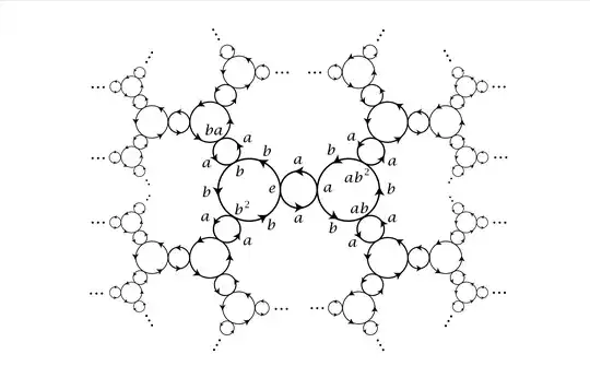

I'm trying to use covering spaces to show that the commutator $[G,G]$ of $G = \mathbb{Z}/2\mathbb{Z} * \mathbb{Z}/3 \mathbb{Z}$ is isomorphic to the free group $F_2$. I can write $G$ as the fundamental group of $X = \mathbb{R}P^2 \vee X_3$ where $X_3$ is constructed as a $2$-cell glued into $S^1$ by a map of degree $3$. The universal cover $\tilde{X}$ of that space is drawn in Hatcher: enter image description here
We know from general covering space theory that $[G,G]$ will be the fundamental group of $\tilde{X} / [G,G]$, the quotient space by the action of $[G,G]$ coming from the covering space action of $G$. It seems that I'm supposed to find that this quotient looks like $S_1 \vee S_1$, but I've been stuck for a while trying to figure out what the quotient looks like.

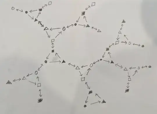

We know that $G = \mathbb{Z}/2 \ast \mathbb{Z}/3 = \langle a, b \mid a^2 = b^3 = 1 \rangle$, so $[G,G]$ (which is generated by all commutators) had better contain the commutators $[a,b]$ and $[b,a]$ (and their inverses). So if we want to consider the quotient of the universal cover by $[G,G]$ (that is, if we want to identify two vertices whenever they differ by a commutator) we might as well start by just using the "obvious" commutators $a^{-1}b^{-1}ab$ and $b^{-1}a^{-1}ba$. So we draw a big piece of the universal cover, label all the vertices, and start seeing which labels have to be identified. A pattern quickly emerges, and we can redraw our picture a second time with new labels to make the pattern particularly obvious:
The universal cover, with colored vertex labels
Note that in this picture there should be 2-cells filling in all the triangles in order for this to be simply connected, which I've omitted to save on visual clutter. We see that $b$ always interchanges square to circle to triangle to square, while $a$ swaps our "shaded" and "unshaded" labels. We quotient by this equivalence relation to get

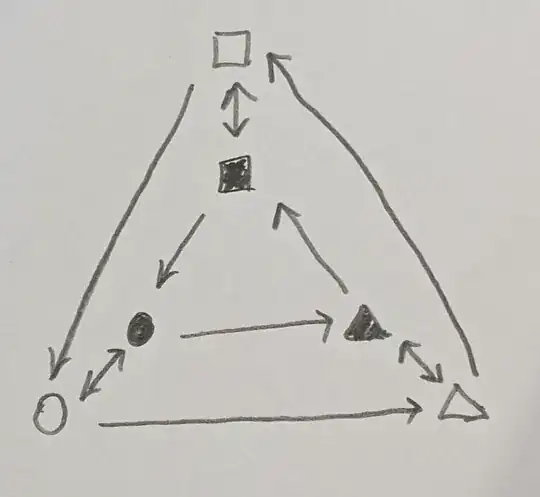

The quotient, a cayley graph for Z/2 times Z/3
Now, we've only quotiented by some of our commutator relations, so in more complicated examples we might have to keep quotienting by more complicated commutators. But in this instance we recognize this graph as the cayley graph for $\mathbb{Z}/2 \times \mathbb{Z}/3$, which is an abelian group. In particular, all our other commutators will already be identified! So we stop, and we've successfully computed the quotient of our universal cover by $[G,G]$.... But what does this buy us?

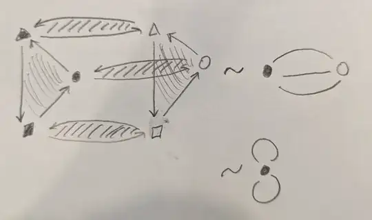

Well, if we draw the 2-cells explicitly, then we can see this quotient is homotopy equivalent to a wedge of 2 circles (as you predicted):
A homotopy equivalence between the quotient and a wedge of circles
So, by your logic from before, we see that $[G,G]$ is the fundamental group of this shape, and thus is $F_2$. But we can say more! The fundamental group is moreover the set of paths from any vertex to itself. If we use the shaded triangle for concreteness we see the two generating loops are the open back face and the open front face, which respectively correspond to $a^{-1} b^{-1} a b$ and $a b a^{-1} b^{-1}$ so that we can moreover say the isomorphism sending $F_2 \cong [G,G]$ sends the generators of $F_2$ to these two words.
