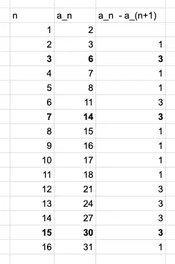

If you listed out the first few terms (see screenshot below), you might realize that we do not have an arithmetic progression. EG $a_1 = 2, a_2 = 3, a_3 = 2 + 2a_1 = 6$.

If you calculated the first few terms of the sequence and found the first difference (see screenshot below), you might notice a pattern of 1's and 3's. This could lead to the conjecture that for $ n > 3$, let $ 2^m \leq n \leq 2^{m+1} -1$, then we have the formula
$$f(n) = \begin{cases} 2(2^m-1) + (n - 2^m+1) & n < 3 \times 2^m \\ 2(2^{m+1}-1) - 3 (2^{m+1} - 1 - n) & n \geq 3 \times 2^m \end{cases}.$$
This can be proven by (strong) induction.
Corollary: For the original problem, conclude that $\frac{a_n}{n} $ is an integer iff $ n = 2^m - 1$.
