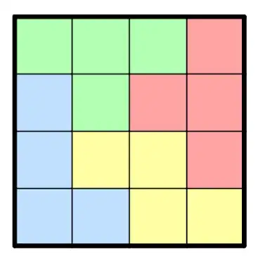

Suppose that I have a $2n \times 2n$ grid which has had $n^2$ tetrominoes packed into it, as in the following illustration:
Tetromino packing

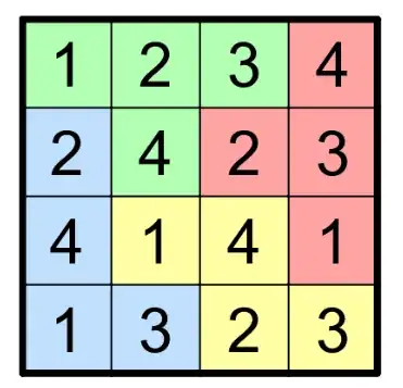

Can I always assign the numbers 1,2,3,4 to the squares of the grid so that (1) each tetromino contains each number exactly once, and (2) orthogonally adjacent squares always receive different numbers? For example, here's a valid coloring of the above packing:
Colored packing
