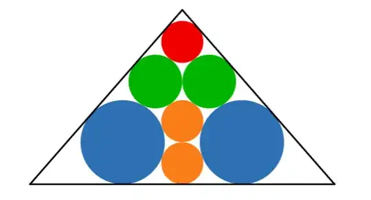

In the diagram, circles of the same color are congruent. Wherever things look tangent, they are tangent.
Show that the red circle is congruent with the orange circles.
I have found a solution, which I post below, but it is not easy without a computer. I am looking for a more elegant solution.

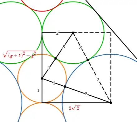

Assume the radius of the orange circles is $1$. Then the radius of the blue circles is $2$.
Let $g=$ radius of the green circles.
Pythagorus gives the two lengths labelled in red below:
Then Pythagorus with the dashed line right triangle gives:
$$\left(2\sqrt2-g\right)^2+\left(1+\sqrt{(g+1)^2-g^2}\right)^2=(g+2)^2$$
$$\implies g=\frac{4+6\sqrt2+4\sqrt{1+\sqrt2}}{9+4\sqrt2}$$
