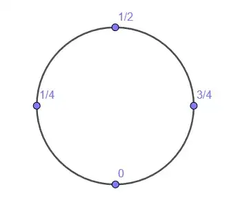

Consider the following circle where each point on the circle is associated with a real in $[0,1)$: enter image description here

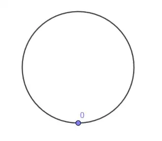

Point $0$
First point is not impacted by C1 and C2 so following C3.1 we obtain $f(0)=0$:

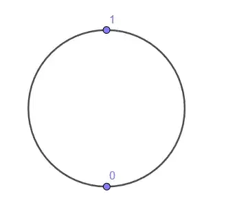

Point $1$
Apply C1 and we only have one point matching so $f(1)=\frac{1}{2}$:

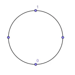

Point $2$
Applying C1 we have two possible points remaining and C2 does not allow to discriminate between them either:
Applying C3.2 selects the following point so $f(2)=\frac{1}{4}$:

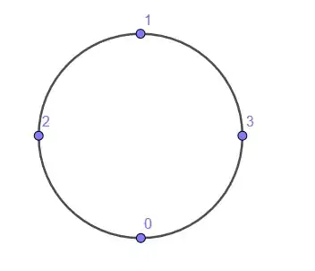

Point $3$
Applying C1 we have a single possible point so $f(3)=\frac{3}{4}$:

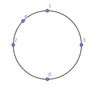

Point $4$

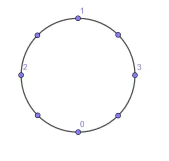

Applying C1 leaves us with 4 possible points:

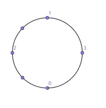

Applying C2 leaves us with 2 possible points:
Applying C3.2 selects the following point so $f(4)=\frac{3}{8}$:

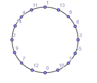

Points $5$ to $15$
Following the same logic for a few more steps we obtain:
  • $f(5)=\frac{7}{8}$
  • $f(6)=\frac{5}{8}$
  • $f(7)=\frac{1}{8}$
  • $f(8)=\frac{11}{16}$
  • $f(9)=\frac{3}{16}$
  • $f(10)=\frac{15}{16}$
  • $f(11)=\frac{7}{16}$
  • $f(12)=\frac{1}{16}$
  • $f(13)=\frac{9}{16}$
  • $f(14)=\frac{5}{16}$
  • $f(15)=\frac{13}{16}$
