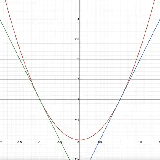

Let me give this example:
We have $f(x)=x^2$ and $x,y=\pm 1$. The slope from $x$ to $y$ (or $y$ to $x$) is $0$. It's the black line in the plot. The slope at $-1$ is $-2$, that's the green line. So we indeed have $-2 \le 0$. But if we pick $x$ and $y$ to be $x=-1$ and $y=1$, then the statement (i) is false, since it would state that $0 \ge 2$.
So to me it seems, the correct definition would be:
(i) $\forall x, y \in \mathbb{R}$ with $x \ge y : f(x) \ge f(y) + f'(y)(x - y)$

  • For $x=-1$ and $y=1$ in statement (i) we have $f(x) = f(-1) = (-1)^2 = 1$ and $f(y) + f'(y)(x-y) = y^2+2y(x-y) = 1^2+2(1)(-1-1)=1-4=-3$ and certainly $1 \ge -3$, so statement (i) is not false for $x=-1$ and $y=1$. – jjagmath May 29 '24 at 11:26

$f(x) \ge f(y) + f'(y)(x - y)$ is only equivalent to $\frac{f(x)-f(y)}{x-y} \ge f'(y)$ when $x - y > 0$. In order to rewrite the first inequality into the second one, you have to divide by $x - y$, and when $x - y < 0$, this reverses the direction of the inequality.
Indeed, for your example, if you check the original inequality, you have $f(x) = 1$, $f(y) = 1$ and $f'(y) = 2$, so $f(y) + f'(y)(x - y) = 1 + 2(-1 - 1) = 1 - 4 = -3$, which is less than $f(x) = 1$.
And more generally, if $f(x) = x^2$, then $f(y) + f'(y)(x - y) = y^2 + 2y(x - y)$. By completing the square (with respect to $y$), this can be rewritten as $x^2 - (x - y)^2$. Since $(x - y)^2$ is always greater than or equal to zero, this expression is always less than or equal to $f(x) = x^2$.
The intuition you should have for (i) is that it states that the function always lies entirely above its tangent lines. $T(x) = f(y) + f'(y)(x - y)$ is the point-slope form of the equation of the line tangent to $f$ at $y$.
