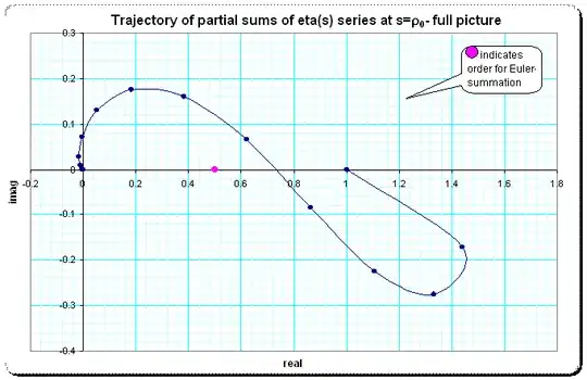

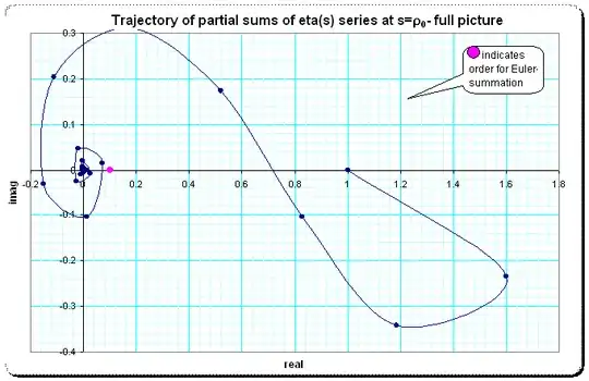

Here is the picture of the trajectory of the partial sums in the complex plane without any Euler-summation (or $o=0$) first. The trajectory begins at $s_1=1+0i$ which is the partial sum using only the first term, then proceeds along the blue line from point to point to arrive eventually at $s_\infty=0+0i$ (update: upps, I see I've the argument in the pictures the letter $s$ which should be $z$ for this discussion here because $s$ denotes here the partial sums, sorry)
We see the spiralling around the expected final value of $0+0i$ and we need hundreds of terms to be near to only three or four decimal digits.

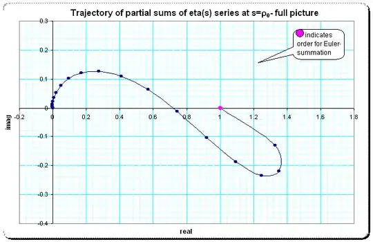

Here is the same computation, but with a small Euler-order $o=0.1$ and number of terms $t=48$: enter image description here
Obviously the convergence to the final value appears much faster and even smoother.

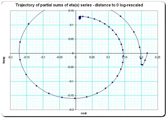

A higher order of Eulersummation ($o=0.5$) improves this further:
This gives even the idea, that the spiralling may be defeated!

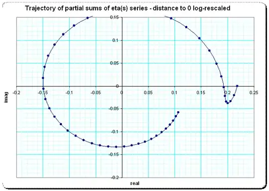

Here is the detail around the origin, where I rescaled the absolute distance to the origin logarithmically so we see, that the spiralling even seem to stop after only 32 or so terms of the partial sums (but this might be a numerical artifact here).

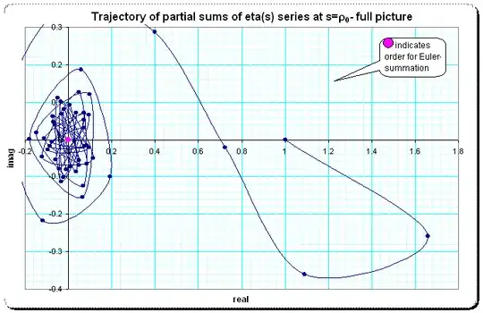

The standard Eulersummation uses order $o=1$ and this gives this impression:
which does not give much improvement (if at all). In the logarithmic rescale around the origin we have no more artifact but can still observe that the arclengthes per step seem to decrease. enter image description here

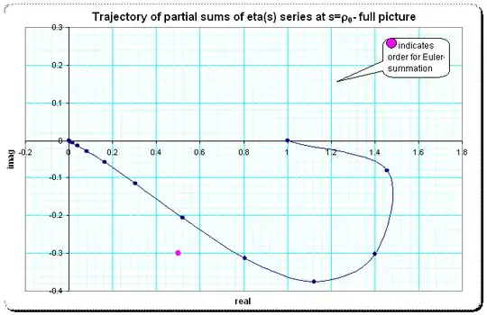

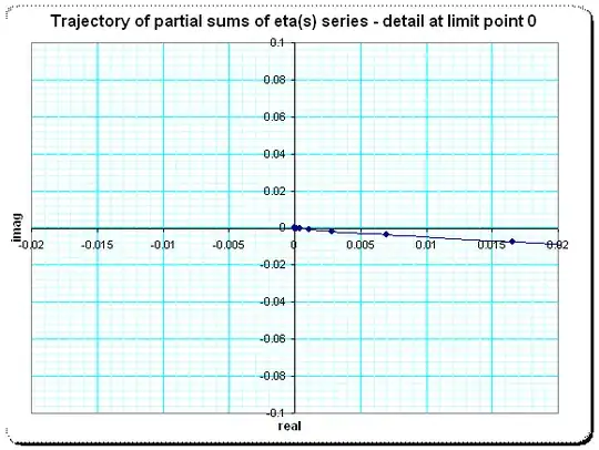

Finally, it seems that there is an "optimal" Eulerorder, but which is even complex. I've the impression, that $o=0.5 - 0.3i$ is in some sense optimal: the final steps of the 48-term-trajectory seem to approach the final value in a nearly linear curve:
and the detail around the origin (here just zoomed in) looks very promising: enter image description here

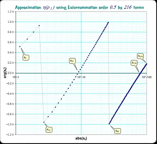

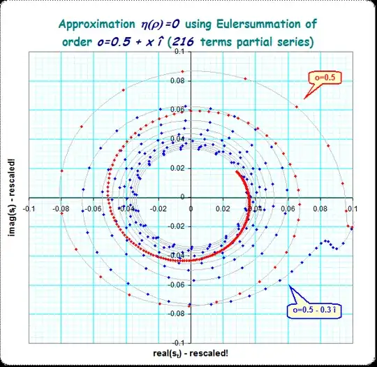

[update] Possibly the last step (the optical improvement using the negative imaginary component of $-0.3i$ for the order $o$ of the Euler-summation) was due to Excel-rounding issues. Using multiprecision Pari/GP I produced the following picture for the order of exactly $o=1/2$ and it seems to be always the best/fastest approximation; the circling around the origin seems unavoidable even if the imaginary component is varied a bit. The following picture shows the approximation of the $s_t$ to the origin in absolute distance (x-axis) and angle (y-axis) for 216 terms of the partial sums $s_t$ (compare the Excel-picture with $o=0.5$. Here I'm leaving out the first $8$ partial sums to keep the picture concise).
Here is an overlay of the numerical more precise computation focusing the angular and the absolute deviation from the origin in rectancular, but logarithmically scaled terms, for the $o=1/2$ and $o=1/2 - 0.3 î$ orders. We see, that both orders approximate similarly in terms of absolute deviation (radii decrease very similarly) but with the $o=0.5$-order the sequence of difference of angles seems to decrease nicely:
