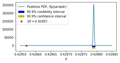

Simulation with your sample-size of $n=10^7$ gave you an observed proportion $\hat p=0.4285833,$ so an approximate confidence interval for $p:=P(a^2<bc)$, with, say a $95\%$ "confidence level", is $$\hat p\pm 1.96\,\sqrt{\hat p(1-\hat p)\over n}=(0.4283, 0.4289)$$
Although $3/7=0.42857...$ does lie in this interval, the interval only esimates $p$ to about three digits of precision. Simulations using a larger sample-size suggest, with a very high degree of confidence/credibility, that $p\ne {3\over 7},$ the difference showing up in the fourth decimal place. Here's a picture of what I find with sample-size $10^{11}$:
confidence- and credibility-intervals for p
The posterior distribution is $\text{Beta}(a,b)$, with $(a,b)=(n\hat p+{1\over 2}, n(1-\hat p)+{1\over 2}).$
The $100(1-\alpha)\%$ credibility interval is therefore $$(B_{\alpha\over 2},B_{1-{\alpha\over 2}})$$ where $B_q$ is the $q$-th quantile of the $\text{Beta}(a,b)$ distribution.
The $100(1-\alpha)\%$ confidence interval is $$\hat p\pm z_{\alpha\over 2}\,\sqrt{\hat p(1-\hat p)\over n}$$ where $z_q$ is the $q$-th quantile of the standard normal distribution.
With the sample-size this large the various approaches to confidence/credibility intervals for $p$ should all give practically the same results (assuming a non-informative prior distribution in the Bayesian methods); e.g., they agree to about six decimal places for a $99.9\%$ confidence/credibility interval, namely
$$0.428790 \pm 0.000005 = (0.428785, 0.428795).$$
(I found no OEIS entries for decimal expansions in that interval, so I can't guess at the exact value.)

  • @ТymaGaidash Of course I hope someone posts an exact answer to the OP's question "What is $P(a^2\lt bc)$?" (I hesitated to post the present "answer", as Monte Carlo simulation obviously cannot provide mathematical certainty -- not even for the title question "Is it 3/7?") – r.e.s. Apr 23 '24 at 15:20
  • @r.e.s. I'm glad you decided to post your answer. I take your point about mathematical certainty, but I can sleep better now, knowing that the probability is probably (lol) not $\frac37$. That $7$ was bugging me :) – Dan Apr 23 '24 at 15:34
