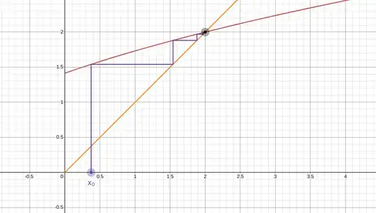

You can see in a cobweb plot that as long as the graph $y = f(x)$ is increasing around $x = L$ but more slowly than $y = x$ (or decreasing but more slowly than $1$ in magnitude), then each iterate is closer to $L$ than its predecessor. Each vertical step connects $(x_n, x_n)$ to $(x_n, x_{n+1})$, and each horizontal step connects $(x_n, x_{n+1})$ to $(x_{n+1}, x_{n+1})$ so that the $x$-coordinate is ready to evaluate again in the function $f$.
Here's an illustration that is interactive. You can drag the initial value $x_0$ on the $x$-axis or modify the function $f$.
Cobweb plot of iterates.
