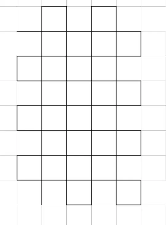

Easily one sees that drawing a sub-grid of $m\times n$ is possible for all values of m and n, by drawing vertical lines and then horizontal lines, without removing the pencil.
Here is an example of a sub-grid of $3\times 6$. enter image description here

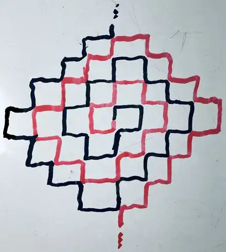

Yes, it is possible, using the method illustrated in this image.
Referring to Especially Lime's comment, this answer used to have an alternate proof which Lime noticed was fallacious, so I deleted that proof.
