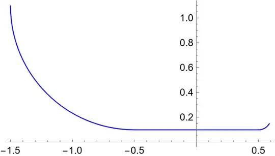

You should be able to come up with examples that are circular arcs and line segments (that are tangent to the arcs where they are met). For instance,
circular arc, tangent line, circular arc
This is the part of the circle centered at $(-1/2,1/10)$ with radius $1$ between angles $\pi$ and $3\pi/2$, the horizontal line segment from $(-1/2,1/10)$ to $(1/2,1/10)$, then the part of the circle centered at $(1/2,1/5)$ of radius $1/10$ between the angles $3\pi/2$ and $11\pi/6$.
Note: There is nothing special about the line segment being horizontal -- that's just easy for me to find an example off the top of my head. As long as the line segment(s) are tangent to the circles at the points where the lines meet their arcs, the result is continuous and has continuous first derivatives, i.e., is $C^1$. The second (and higher) derivatives are not continuous at the points where these arcs and segments meet. Also, a detail of the example is that the graphed function is continuous on $[-3/2,1/2+\sqrt{3}/20]$, but the derivative is only continuous on $(-3/2,1/2+\sqrt{3}/20]$ (being undefined where the tangent is vertical).
Eric Towers
  • 70,953
    "Smooth" normally means it must be infinitely differentiable; so having continuous first derivatives is not sufficient. – kaya3 Feb 29 '24 at 17:17
    But OP's "formal question" only specified $f''$, so it's possible this meets their expectations. – Teepeemm Feb 29 '24 at 21:34
    @kaya3 : "Smooth" is one of those floppy words whose meaning is context dependent. If one means infinitely differentiable, one says so. If one's context only requires $C^1$ to be "smooth", one says so. See https://algebrademystified.wordpress.com/2017/08/20/degrees-of-smoothness/ for a short discussion of the varied usages of "smooth". OP's formal question only requires that $f''$ is $0$ on a closed interval and is nonzero somewhere else, which my example demonstrates. (It's even $C^2$.) – Eric Towers Mar 01 '24 at 03:21
  • @Teepeemm OP's question specified that the function be smooth and have zero curvature on a finite interval. The question uses the second derivative to specify the latter condition, not the former. – kaya3 Mar 01 '24 at 11:56
  • My "It's even $C^2$." is a typo. I had intended "It's even $C^1$." but didn't notice until too late to edit the comment. (If this is the worst thing I did that day, it was probably a pretty good day.) – Eric Towers Mar 01 '24 at 17:50
