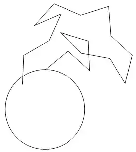

Consider a two dimensional random walk with step size $1$ and each step in a random direction, with the angle $\theta$ uniformly distrbuted in $[0,2\pi)$. The walk starts on the perimeter of a disk of radius $r$.
What is probability that the walk will ever return to the disk, in terms of $r$?
By "the walk will ever return to the disk", I mean the walk will have a vertex on or within the perimeter of the disk, besides the initial one.
