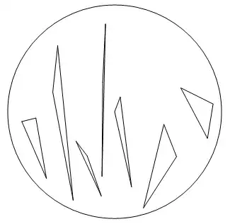

Choose $3n$ independent uniformly random points in a disk with perimeter $x^2+y^2=1$. Label the points $P_1,P_2,P_3,\dots,P_{3n}$ in order of increasing $x$-coordinates. Form triangles $\triangle P_1P_2P_3,\space \triangle P_4P_5P_6,\space \dots,\space \triangle P_{3n-2}P_{3n-1}P_{3n}$.
Here is an example with $3n=21$.
What does the total area of the triangles approach as $n\to\infty$ ?
I did a simulation of $100$ trials with $3n=99999$, and the average total area was $0.318343178$. This number multiplied by $\pi$ is approximately $1.00010$, so I conjecture that the answer is $1/\pi$.

I'll sketch an argument that shows that the constant converges to ~$0.3198$. Hopefully it is not too hand-wavy.
Assume that first of all you randomize all $x$ values. Then you sort the numbers, and only then you randomize the $y$ values. A triple of points have values $x_0$, $x_1$, and $x_2$. Look at the strip $\{(x,y)\ |\ x_0 \le x \le x_2\} \subset D^2$. We can approximate this strip as a rectangle, and re-normalize it such that $x_0 = 0$, $x_2 = 1$, and that the $y$ values are between $0$ and $1$.
Then the $x_1, y_0, y_1, y_2$ are random numbers that are randomized with a uniform distribution between $0$ and $1$. The lengths of the sides of the resulted triangle are:
$d_1 = \sqrt{x_1^2 + (y_1 - y_0)^2}$
$d_2 = \sqrt{(1 + (y_2 - y_0)^2}$
$d_3 = \sqrt{(1-x_1)^2 + (y_2 - y_1)^2}$
and the formula for the size of the triangle is:
$Area(\Delta) = \sqrt{s (s-d_1)(s-d_2)(s-d_3)}$
where $s = \frac{d_1+d_2+d_3}{2}$.
From this we can calculate the expectation of the size of this triangle by:
$\int_0^1 \int_0^1 \int_0^1 \int_0^1 Area(\Delta)dx_1 dy_0 dy_1 dy_2$
Which is a terrible integral, and numerically, it equals to ~$0.1527$.
Now, that means that ~$15.27\%$ of the strip above was covered by the triangle, on average. Note that between each strip and strip, we have an "empty strip", whose width is half of the width of the strips with the triangles, on average. Hence, we expect a total of
$ \frac{2}{3} \cdot 15.27 \% = 10.18 \%$
of the disc to be covered by the triangles. Multiplying by the area of the disc, we get $0.1018\pi = 0.3198$ which is not far from your simulations.
If anyone is brave enough to solve the integral above, we will know what is the actual constant, assuming that my argument is not too hand-wavy. (@Kroki solved the integral, see his answer!)

Let's consider the following problem:
Given a square of size $1$. Choose two random points on the vertical borders and one inside the square. What is the expected area of the triangle covered by the three points?
We can call the value $\tau$. Fix the border points $(0, y_0)$ and $(0, y_1)$ and the abscissa of random inside point as $x$. Let $\mathcal A$ be the area not covered by the triangle:
\begin{align} \mathbb E\left[\mathcal A|y_0, y_1, x\right] &= \frac12\left(y_0 + y_1\right)\left(1-(xy_1 + (1-x)y_0\right) + \int_{xy_1 + (1-x)y_0}^{1} \frac12x\left(1-y_0 + 1-y\right)\mathrm d y + \int_{xy_1 + (1-x)y_0}^{1} \frac12(1-x)\left(1-y_1 + 1-y\right)\mathrm d y + \frac12\left(1-y_0 + 1-y_1\right)\left(xy_1 + (1-x)y_0\right) + \int_{0}^{xy_1+(1-x)y_0} \frac12x\left(y_0+y\right)\mathrm d y + \int_{0}^{xy_1 + (1-x)y_0} \frac12(1-x)\left(y_1 + y\right)\mathrm d y\\ &= \frac12y_0 + \frac12y_1 + xy_1 + (1-x)y_0 - \left(y_0 + y_1\right)\left(xy_1 + (1-x)y_0\right) + \frac12\left(1-xy_0 - (1-x)y_1\right)\left(1-xy_1-(1-x)y_0\right) + \frac14\left(1-xy_1-(1-x)y_0\right)^2 + \frac12\left(xy_0 + (1-x)y_1\right)\left(xy_1 + (1-x)y_0\right) + \frac14\left(xy_1 + (1-x)y_0\right)^2 \end{align}
Now,
\begin{align} 1-\tau &= \mathbb E\left[\mathcal A\right]\\ &= \mathbb E\left[y_0 + y_1\right] - \frac12\mathbb E\left[(y_0 + y_1)^2\right] + \frac12 - \frac12\mathbb E\left[y_0 + y_1\right] + \frac23\mathbb E\left[y_0y_1\right] + \frac16\mathbb E\left[y_1^2 + y_0^2\right] + \frac1{6}\mathbb E\left[y_0y_1\right] + \frac16\mathbb E\left[y_1^2 + y_0^2\right]\\ &= 1 - \frac12\times \frac{7}{6} + \frac23\times \frac14 + \frac16 \times \frac23 + \frac16\times \frac14 + \frac16\times \frac23\\ &= 1-\frac{11}{72} \end{align}
using the argument of @Rei's answer the final answer is $\frac23\tau$.
Kroki
  • 13,619
  • Call the vertices of your triangle $(0,A),(B,C),(1,D)$. Using the shoelace theorem, $\tau=\int_0^1\int_0^1\int_0^1\int_0^1\frac12|-AB+BD-C+A|dAdBdCdD$, and according to desmos this is $0.152777777779$, which seems to be $\frac{11}{72}$. Then $\frac23\tau\pi=\frac{11}{108}\pi\approx 0.319977$. Is this the answer? – Dan Feb 01 '24 at 01:51
  • Yes, it is the exact answer that I computed. – Kroki Feb 01 '24 at 02:05
  • You can use the shoelace theorem and start by fixing $A$, $B$, and $D$. After that, you compute the integral only for $C$. The remaining integral is computable since it contains only polynomials in $A$, $B$, and $C$ and you find the value of $\tau$. – Kroki Feb 01 '24 at 02:17
  • We should multiply your answer by $\pi$, since the OP has a unit disk instead of a unit square lamina. So the final answer should be $\frac23 \tau\pi=\frac{11}{108}\pi$. – Dan Feb 01 '24 at 06:26
    Yes of course. I was computing the value of the of the ratio of the two area. After that you need to multiply it by the area of the shape that you have. – Kroki Feb 01 '24 at 08:53
