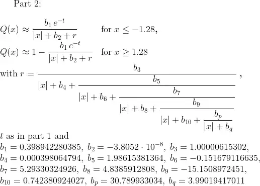

Urged by the hint in the comment (links can rot away over time) here the formula "Q part 2" referenced above:
Q part 2
I documented it according the found procedure before I knew about its origin in "Algorithm 39".
Note, $t=x^2/2$

  • So $b_{2} = -3.8052 \cdot 10^{-8}$? Is this some "magic constant" or is it known where this number comes from? – njuffa Jan 24 '24 at 01:05
  • Yes, correct. This constant comes from "Algorithm 39", to call it $b_2$ is my idea when I showed it as formula Q part 2 – m-stgt Jan 24 '24 at 01:51
  • References (as links or otherwise) are appreciated but it is much preferred when questions are self-contained (links can rot away over time). This use of $b_{2}$ does not make sense to me. If this were IEEE-754 single-precision computation, one might consider a rounding constant of sorts, possibly to keep errors one-sided, but his is 10-digit decimal computation from what I understand. – njuffa Jan 24 '24 at 02:34
  • There are two more exceptional factors, two pettily different versions of the constant $\displaystyle \frac{1}{\sqrt{2\pi}}$, 0,398942280444 and 0,398942280385. Probably to get correct results to the last digit.
    Yes, numbers on the HP32E have a 10-digit mantissa for the user, internaly the exponent is saved in another register what enables computing with 13 digits. Results for the user are rounded.
    – m-stgt Jan 24 '24 at 03:03
