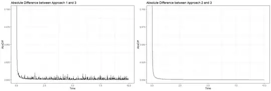

In the above graphs, the results of all 3 approaches look quite similar to one another.
I then compared the absolute differences between Approach 1 and Approach 3, and between Approach 2 and Approach 3:
abs_diff_1_3 <- abs(dXt_1 - dXt_3)
abs_diff_2_3 <- abs(dXt_2 - dXt_3)
p5 <- ggplot(data.frame(Time = t, AbsDiff = abs_diff_1_3), aes(Time, AbsDiff)) + geom_line() + labs(title = "Absolute Difference between Approach 1 and 3") + theme_bw()
p6 <- ggplot(data.frame(Time = t, AbsDiff = abs_diff_2_3), aes(Time, AbsDiff)) + geom_line() + labs(title = "Absolute Difference between Approach 2 and 3") + theme_bw()
enter image description here Again, all results look quite similar to one another.
My Question: Based on this exercise, it seems like whether you take the correct derivative (via Ito's Lemma) or the incorrect derivative (basic calculus), the final answer looks very similar. Thus, is Ito's Lemma more of a theoretical consideration with little added value compared to the incorrect derivative? Or perhaps there are much bigger differences for the derivatives of other functions (and perhaps for stochastic integrals)?
Thus, for stochastic functions, is there any "real danger" in incorrectly calculating their derivatives and integrals using basic calculus methods?

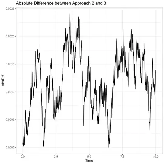

Instead, let us pick another process such that the Ito formula and standard calculus disagree. Set $W_t$ to be a standard BM and $$ X_t = \mu t + \sigma W_t^3 $$ so that the standard calculus approach gives $$ dX_t = \mu dt + 3\sigma W_t^2 dW_t $$ and the Ito lemma yields $$ dX_t = (\mu + 3 \sigma W_t) dt + 3 \sigma W_t^2 dW_t. $$ Then, running the same code as you, but modified to this process, I get the following results.

dWt <- c(0, diff(Wt)) dXt_2 <- mu * dt + 3 * sigma * (Wt ^ 2) * dWt p3 <- ggplot(data.frame(Time = t, dXt_2 = dXt_2), aes(Time, dXt_2)) + geom_line() + labs(title = paste("Approach 2: Incorrect Derivative\nmu =", mu, ", sigma =", sigma)) + theme_bw()
Approach 3: Correct Derivative using Ito's Lemma
dXt_3 <- mu * dt + 3 * sigma * (Wt ^ 2) * dWt + 3 * sigma * Wt * dt p4 <- ggplot(data.frame(Time = t, dXt_3 = dXt_3), aes(Time, dXt_3)) + geom_line() + labs(title = paste("Approach 3: Correct Derivative using Ito's lemma \nmu =", mu, ", sigma =", sigma)) + theme_bw()
abs_diff_1_3 <- abs(dXt_1 - dXt_3) abs_diff_2_3 <- abs(dXt_2 - dXt_3)
Do you still believe that Ito's lemma is just a theoretical exercise? In fact, note that the difference is $3\sigma W_tdt$, so we actually expect the error to grow as $t \to \infty$ in this case! If n = 10000 instead in the above code, we get the following error plot:
