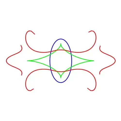

A toy constructed in MATHEMATICA which giving two curves in parametric representation, try to calculate the specular curve (in red) for g[t] (in green) having as mirror f[t] (in blue). The calculations are rather simple.

Clear[especular] especular[f_, g_, range_] := Module[{t, n, sol, pg, data = {}, lambda, equs, ps, tk, tau, sols}, For[tk = range[[1]], tk <= range[[2]], tk += range[[3]], n = D[f[t], t, t]; equs = (f[t] + lambda n - g[tau]) /. {t -> tk}; sols = Sort[{lambda, tau} /. Quiet@Solve[equs == 0, {lambda, tau}, Reals] /. {C[1] -> 0}]; pg = g[tau] /. Thread[{lambda, tau} -> sols[[1]]]; ps = (f[t] - lambda n) /. Thread[{lambda, tau} -> sols[[1]]] /. {t -> tk}; AppendTo[data, ps] ]; Return[data] ]

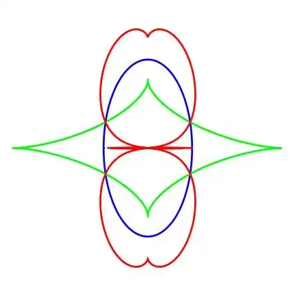

data = especular[g, f, {-Pi, Pi, 0.01}]; gr1 = ParametricPlot[f[t], {t, -Pi, Pi}, PlotStyle -> Blue]; gr2 = ParametricPlot[g[t], {t, -Pi, Pi}, PlotStyle -> Green]; gr3 = ListLinePlot[data, PlotStyle -> Red]; Show[gr1, gr2, gr3, PlotRange -> {{-6, 6}, {-6, 6}}, Axes -> False]
The specularparameters are f is the function $f(t)$ name, g is the function $g(t)$ name, and range is a list with three values: $\{t_{min},t_{max}, \Delta t\}$. Follows a plot showing the case
$$ \cases{ f(t) = \{a\cos t, b\sin t\}\\ g(t) = \frac{a^2-b^2}{a b}\{b\cos^3 t,-a\sin^3 t\}, a = 1, b = 2\\ t_{min}= -\pi, \ t_{\max} = \pi, \ \Delta t = 0.01\\ } $$
Cesareo
  • 36,341
    You may add the curves are evolutes, so solving the equation for their intersection with a line is simpler – Тyma Gaidash Dec 10 '23 at 22:57
    As I said, it is a toy that will try to solve the proposed problem. Non parametric versions can be programed also. I have one but is quite messy to explain. – Cesareo Dec 10 '23 at 23:04
