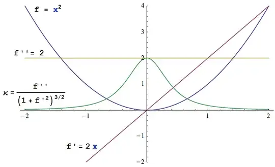

Just as a little addendum to Shine's answer who already pinpoints it, here a neat plot for intuitive illustration. The difference between the Hessian of a function $f$ and its actual local curvature at some point $x$ is best illustrated by a simple quadratic function $f=x²$. Its Hessian $f''=2$ is globally constant, while its curvature $\kappa$ of is obviously not. The determinant of the Hessian equals the curvature only if evaluated at an extremum ($f'=0$).
Derivatives and curvature of x²
