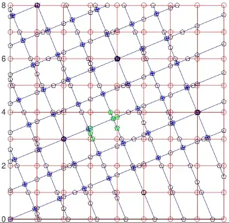

Fig. 1 : The "big picture" displaying many different cases.

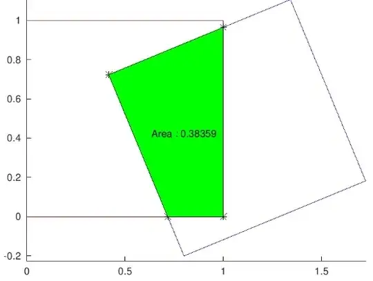

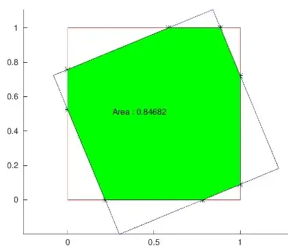

Fig. 2 : An octagonal case (Fig. 2 and Fig. 3 are created by the program below "playing on" translation vector $V$).
Fig. 3 : The case of a quadrilateral.
Your problem can be reduced to a classical issue : the determination of the intersection of 2 "filled" convex polygons $(A)$ and $(B)$ with vertices $A_1,A_2...$ and $B_1,B_2...$.
It is based on 2 principles (implemented as 2 functions in the Matlab program below)
  • ("getting new points by side intersections") Testing whether side $A_pA_{p+1}$ intersects side $B_qB_{q+1}$ (of course, most of them have no intersection). Build a list $(L)$ of all these intersections.
  • ("keeping inside vertices") Add to list $(L)$ all vertices $A_p$ which are inside polygon $(B)$ and, in a symmetrical way, all vertices $B_q$ which are inside polygon $(A)$.
Points of $(L)$ are the looked-for vertices of the intersection.
I have written (see below) a Matlab program in the case where polygons $(A)$ and $(B)$ are squares. $(A)$ has been taken WLOG to be the square $[0,1] \times [0,1]$ ; square $(B)$ is obtained from square $(A)$ by a rotation followed by a translation.
This program can be translated into another language ; you will just have to account for some "idiosyncrasies" of Matlab language I have used. For example, the last lines of the program use the "convhull" function ("convhull" = convex hull) yielding an anticlockwise ordering of points in $(L)$ and a computation of the common area.
Change the translation vector $V$ in order to see different cases.
