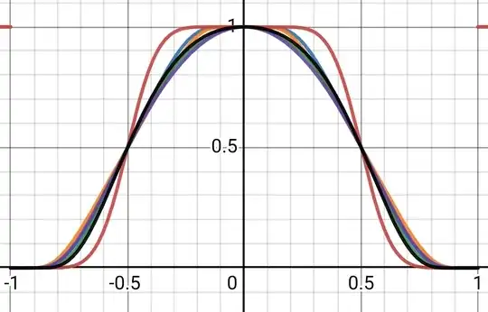

Consider the following functions as $$F_i(x)=\begin{cases} \frac{f_i(x)}{I_i},\quad x<|1| \\ 0,\quad |x|\geq 1\end{cases}$$ where $I_i$ is a normalizing constant such as $\int\limits_{-\infty}^{\infty} F_i(x)\ dx=1$ and $f_i(x)$ are the following functions:
  1. $$f_1(x)=\frac{1}{1+\exp\left(\frac{1-2|x|}{x^2-|x|}\right)}$$ which resembles the lobes of the Fabius function and Rvachëv function (which fulfills $R'(x)=2R(2x+1)-2R(2x-1)$), as could be seen in Desmos through the approximation shown in this answer.
  2. $$f_2(x)=\frac{1}{1+\exp\left(\frac{\frac{\sqrt{3}}{2}\left(1-2|x|\right)}{x^2-|x|}\right)}$$ which have "almost" straight-line "sides".
  3. $$f_3(x)=\frac{1}{1+\exp\left(\frac{2\left(1-2|x|\right)}{x^2-|x|}\right)}$$ which look it have an "almost flat function top": I wasn't able to prove it, but by inspection they look indeed flat, and as also $f_1(x)$ both looks are not analytic at $x=0$ which is a good syntom, as can be seen in Wolfram-Alpha.
  4. $$f_4(x)=\exp\left(\frac{\ln(4)x^2}{|x|-1}\right)$$
  5. $$f_5(x)=\exp\left(\frac{\ln(8)x^2}{x^2-1}\right)$$
  6. $$f_6(x)=\exp\left(\frac{2(2-\sqrt{2})\ln(2)x^2}{\sqrt{|x|}-1}\right)$$
All these functions fulfills $f_i\left(\pm\frac12\right)=\frac12$, $f_i(\pm 1)\to 0$, and $f_i(0)\to 1$ ("arrows" meaning "tendency under the limit" sense).
You could see these functions here on Desmos.
example functions
I am trying to understand Mollifiers through these examples, which all of them "look smooth" but some have "avoidable issues", like undefined values but where the function is continuous (like $f_1(x)$ at $x=0$ - check this answer), or their derivatives rises Dirac's delta functions because of the absolute values but that are avoidable by defining the same functions piecewise (like in this other question), so I am trying to figure out if smoothness (being class $C^\infty$) is hold or not on these cases.
As example, $f_1(x)$ could be constructed as is shown here by choosing $f(x)=\exp\left(-\frac{1}{x}\right)\theta(x)$ with $\theta(x)$ the Heaviside step function, then making $g(x)=\frac{f(x)}{f(x)+f(1-x)}$ and then lets $f_1(x)=g\left(\frac{x-a}{b-a}\right)\cdot g\left(\frac{d-x}{d-c}\right)$ with $a=-1,\ b=c=0,\ d=1$, as could be seen in Desmos. Moreover, a simular construction is used in this answer in MSE to built an example of a smooth transition function so in the case of $f_1(x)$, in principle, the points were could be some issues should be $x=\{-1;\ 0;\ 1\}$.
I am specialy worried about the behaviour at $x\to 0$: at the edges $\partial x =\{-1;\ 1\}$ I know that since how I defined $F(x)$ some of these functions will hold smoothness there: $$\lim\limits_{x\to\partial x^\pm} \frac{d^n}{dx^n}F_i(x)=0\quad n\geq 0,\ n\in\mathbb{Z}_{+}$$ but for others as is showed on Desmos it could be some problems at the edges $\partial x$: I don't know if it is a Desmos' software issue or indeed $f_1(x)$ lost smoothness at higher derivatives as example.
Also, I am not really sure if the definition of $F(x)$ as stated is equivalent to consider $\frac{f_i(x)}{I_i}\theta(1-x^2)$, neither if all these "situations" could be avoided since Mollifiers kernels are evaluated under an integral sign in convolution operations, so in principle, a zero-measure point shouldn't have an impact in the final value, but this is not necessarily true for distributions (just think of the Dirac's Delta function example), so I am trying to understand what criterion applies on each example. As counterexample, you could check in Wolfram-Alpha that $\int\limits_{-\infty}^\infty F_1(x)\ dx=1$, even when $F_1(x=0)$ is undefined.

    Thanks to L'Hospital's rule, if you can show that $\lim_{x \to 1^-} f^{(n)}(x) = 0$ for every $n$, it will follow that $f$ is infinitely differentiable at $1$. As a warmup, try $f(x) = e^{-1/(1-x)}$. Prove by induction that $f^{(n)}(x)$ is of the form $g_n(x) e^{-1/(1-x)}$ where $g_n$ is a rational function. Since exponentials grow faster than polynomials, it follows that $f^{(n)}(x) \to 0$ as $x \to 1^-$. Similar techniques should work for the functions here, though the algebra could be messier. – Nate Eldredge Jun 18 '23 at 00:45
  • @NateEldredge Thanks for commenting, its interesting. I tried to did something in the direction you point in this question but I got anyway many "dislikes": the problem as I saw it in this question examples, is that many will rise problems at $x\to 0$ since is were will be centered the dirac's delta functions of the derivatives of $|x|$ as also some get a division by zero in the exponential exponent. – Joako Jun 18 '23 at 01:06
    I would be interested in going into researching this problem with you. How to contact? – Clemens Bartholdy Jun 19 '23 at 09:04
  • @HopefulWhitepiller Thanks for getting interested. I new to this but I tried to made a chat room in this link – Joako Jun 19 '23 at 16:41
  • @HopefulWhitepiller Hi. I don't know why the chat room link now is missing. I have added some comments about what I have learned about $f_1(x)$ in other questions like this one answered and this one open: if the last one answer is affirmative, I think $f_1(x)$ and related could still be used as mollifiers. Did you were able to take the time to work on them? – Joako Jul 05 '23 at 19:40
  • @NateEldredge You meaning like the demonstration shown in Wikipedia?? It don't mention L'Hopital – Joako Jul 11 '23 at 02:21
    @Joako: Yeah, there are certainly different ways to do it. At the lowest level, they all end up relying on pretty much the same limit computations. – Nate Eldredge Jul 11 '23 at 03:38
  • @NateEldredge In this answer someone used a different approach that looks simpler at first glance, so much, that I don't know if it is indeed right. – Joako Jul 11 '23 at 03:46
    I just saw you linked this question from the other one. It seems to me you should be able to easily reuse the answer I gave there directly at least for cases 1-3. For 4-6 I'm not so sure, because the numerator in the exponent is of higher degree than the denominator, but you should be able to find patterns similar to what I explored in my answer and apply them in 4-6, too. – Al.G. Jul 18 '23 at 19:54
  • @Al.G. Both questions aims to something slightly different: in the other one I was asking if fixing $f_1(x)$ by a piecewise definition would help to keep smoothness. In this one, there is no fix for $f_1(x)$ at $x=0$, so I am trying to understand if when using Mollifiers these non-zero measure points where the function is undefined are a problem that need to be previously fixed, or conversely, it doesn't matter because of being under a integration sign. I believe $f_1(x)$ to $f_3(x)$ should behave in the same way, and the following $f_4(x)$ to $f_3(x)$ also in the same way among them. – Joako Jul 18 '23 at 20:05
