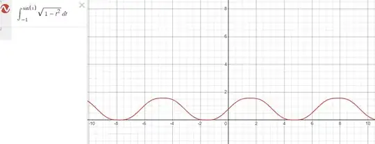

Suppose our integral looked like the following: $\displaystyle \int_{-1}^{\sin(x)}\sqrt{1-t^2}dt$. Graphically, we have:

Well, by $(\dagger_1)$ and imposing that $g(\cdot)=\sin(\cdot)$:
$$\int_{-1}^{\sin(x)}\sqrt{1-t^2}dt=\int_{?}^{x}\sqrt{1-\sin^2(t)}\cos(t)dt \quad (\dagger_3)$$
There is a '$?$' symbol in the lower bound on the right side (and we'll get to that shortly), but, first, let us make one thing clear: $\sqrt{1-t^2} \neq \sqrt{1-\sin^2(t)}\cos(t)$...i.e. these two functions are not the same (go graph them and convince yourself).
Now, time to address the '$?$' symbol. From referencing $(\dagger_1)$, it should be clear why the left side upper bound of integration was $\sin(x)$ and why the right side upper bound of integration was $x$. However, $\sin(x)$ (without any sort of domain restriction) is not an injective function. As such, because we are imposing that $g=\sin$, the left lower bound bound of integration is implicitly saying $g(a)=\sin(a)=-1$. But because a non-restricted $\sin$ is not injective, there is no inverse $g^{-1}$ for us to trivially solve the above expression... i.e. we cannot write $a=g^{-1}(-1)$. We know that $\sin(-\frac{\pi}{2})=-1$...but, more generally, we know that $\sin(-\frac{\pi}{2}-2\pi k)=-1$. For convenience, suppose we choose $k=0$ and $k=1$. Then, adhering to the $(\dagger_1)$ structure, it would seem perfectly legitimate to rewrite $(\dagger_3)$ as both:

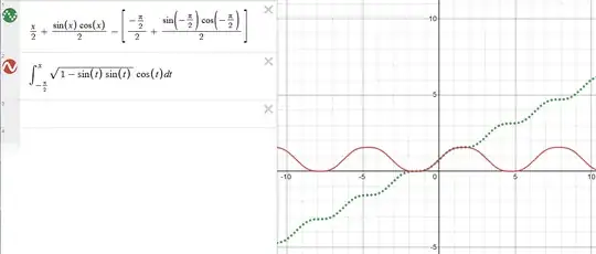

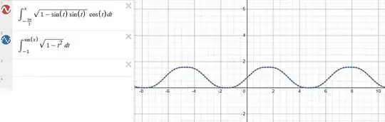

  1. $\displaystyle \int_{-1}^{\sin(x)}\sqrt{1-t^2}dt=\int_{-\frac{\pi}{2}}^{x}\sqrt{1-\sin^2(t)}\cos(t)dt$
  2. $\displaystyle \int_{-1}^{\sin(x)}\sqrt{1-t^2}dt=\int_{\frac{-5\pi}{2}}^{x}\sqrt{1-\sin^2(t)}\cos(t)dt$
Indeed, you can see graphically that both of these statements are true (as the red line and dotted blue lines perfectly coincide...note the different lower bound of integration for the red lines):

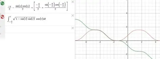

Let's return to the author's solution manual argument. Recall that the author implicitly argues: $\sqrt{1-\sin^2(t)}\cos(t)=\cos^2(t)$. The only way this is true is if we agree to the assertion that $\sqrt{1-\sin^2(t)}=\cos(t)$. Realize, though, that this is only true if $t \in [-\frac{\pi}{2}+2\pi m, \frac{\pi}{2}+2\pi m]$. If, instead, $t \in [\frac{\pi}{2}+2\pi m, \frac{3\pi}{2}+2\pi m]$, then $\sqrt{1-\sin^2(t)}=-\cos(t)$. From the perspective of the $(\dagger_1)$ representation, this matters (although, as we will see later, this issue is irrelevant for the $(\dagger_2)$ representation).
For convenience, let us focus on $\displaystyle \int_{-\frac{\pi}{2}}^{x}\sqrt{1-\sin^2(t)}\cos(t)dt$. Referencing the author's solution, you may be tempted to say $\displaystyle \int_{-\frac{\pi}{2}}^{x}\sqrt{1-\sin^2(t)}\cos(t)dt=\frac{x}{2}+\frac{\sin(x)\cos(x)}{2}-\left[\frac{-\frac{\pi}{2}}{2}+\frac{\sin\left(\frac{-\pi}{2}\right)\cos\left(\frac{-\pi}{2}\right)}{2}\right]$...and this would be just fine assuming we restrict $x$ to $[-\frac{\pi}{2},\frac{\pi}{2}]$. Refer to the below graph, and notice the location where the overlap takes places:
Picture 4
Take my word for it...it's on the interval $[-\frac{\pi}{2},\frac{\pi}{2}]$.

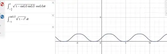

Instead of assuming $\sqrt{1-\sin^2(t)}=\cos(t)$, let's instead assume that $\sqrt{1-\sin^2(t)}=-\cos(t)$. Then you may be tempted to say:
$\displaystyle \int_{-\frac{\pi}{2}}^{x}\sqrt{1-\sin^2(t)}\cos(t)dt=-\frac{x}{2}-\frac{\sin(x)\cos(x)}{2}+\left[\frac{-\frac{\pi}{2}}{2}+\frac{\sin\left(\frac{-\pi}{2}\right)\cos\left(\frac{-\pi}{2}\right)}{2}\right]$...and this would be just fine assuming we restrict $x$ to $[-\frac{3\pi}{2},-\frac{\pi}{2}]$. Refer to the below graph, and notice the location where the overlap takes places:
Picture 5
Take my word for it...it's on the interval $[-\frac{3\pi}{2},-\frac{\pi}{2}]$.
You may be wondering to yourself, "Why is the overlap only taking place at that one isolated interval?" Well, you need to realize that as $x$ varies continuously across the number line, we will experience alternating patterns of when $\sqrt{1-\sin^2(t)}=\cos(t)$ and when $\sqrt{1-\sin^2(t)}=-\cos(t)$, which means, for example if I want to find an expression that is equivalent to $\displaystyle \int_{-\frac{\pi}{2}}^{x}\sqrt{1-\sin^2(t)}\cos(t)dt$ for an $x \lt -\frac{3\pi}{2}$, or for an $x \gt \frac{\pi}{2}$, I would have to make a more complicated expression that takes into consideration the alternating $-\cos(t)$ and $\cos(t)$. Consider, for example, the piece-wise function:
$$\int_{-\frac{\pi}{2}}^{x}\sqrt{1-\sin^2(t)}\cos(t)dt=\begin{cases}\frac{x}{2}+\frac{\sin(x)\cos(x)}{2}-\left[\frac{-\frac{\pi}{2}+2\pi m}{2}+\frac{\sin\left(\frac{-\pi}{2}+2 \pi m\right)\cos\left(\frac{-\pi}{2}+2 \pi m\right)}{2}\right] \quad &\text{if } x \in [-\frac{\pi}{2}+2 \pi m,\frac{\pi}{2}+2 \pi m] \text{ for any }m \in \mathbb Z \\ -\frac{x}{2}-\frac{\sin(x)\cos(x)}{2}+\left[\frac{-\frac{\pi}{2}+2 \pi m}{2}+\frac{\sin\left(\frac{-\pi}{2}+2 \pi m\right)\cos\left(\frac{-\pi}{2}+2 \pi m\right)}{2}\right]\quad & \text{if }x \in [-\frac{3\pi}{2}+2 \pi m,-\frac{\pi}{2}+2\pi m] \text{ for any }m \in \mathbb Z\end{cases}$$
