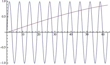

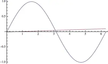

Here's a graph of $y = \sin x$.
The red line is $\sin x$ if $x$ is interpreted as an angle in degrees, and the blue line is $\sin x$ if $x$ is interpreted as an angle in radians. See the difference?
Here's a zoomed-in version
What is $\sin(1.57\text{ rad}),$ and what is $\sin(1.57˚)?$
Intuitively, you can think of $\sin(x˚)$ as a "stretched out" version of the original graph. As a result, the slope of the tangent flattens, changing the derivative.

Thanks, I see the difference, but my question is actually, why are they different? – user1534664 Aug 13 '13 at 01:55
Well, let me ask you this: if $\frac{\pi}{2}\approx 1.57$, then what is $\sin(1.57)$ (1.57 in radians), and what is $\sin(1.57˚)$? – Ben Grossmann Aug 13 '13 at 01:57
