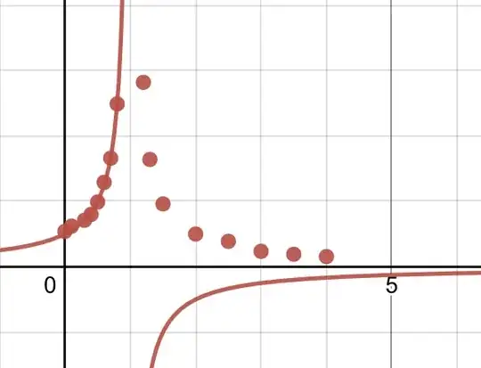

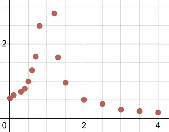

Here is a plot of the error between the $\delta(x)$ series approximation and Wolfram Alpha’s result: $$y\cot(y)=x,\lim_{N\to\infty}\frac1{2\pi}\int_0^\frac\pi2\sum_{n=-N}^N e^{i n(\tan(t)-xt)}dt-\frac1{\sec^2(y)-x}:$$
Finding the error term helps find the series solution to $y\cot(y)=x$. We know that the error when $x=2$ gives error$=\frac12$ and the error when $x=1$ diverges. However, there is no formula for $x>1$.
After tinkering, one finds the error for $0<x<1$ is $\frac1{2(\sec^2(0)-x)}=\frac1{2(1-x)}$:

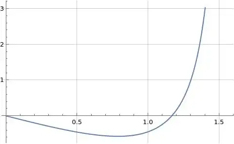

Figure (1) illustrates the function
$f(t)=\tan (t)-2 t\tag{1}$
has a zero at $t=0$ as well as a zero at $t\approx 1.16556$.
f(t) defined in formula (1)
Figure (1): Illustration of $f(t)$ defined in formula (1)

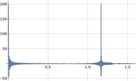

Figure (2) illustrates $\delta(f(t))$ using the limit representation
$$\delta(t)=\underset{f\to\infty}{\text{lim}}\left(2 f\, \text{sinc}(2\, \pi f\, t)\right)\tag{2}$$
evaluated at $f=100$ has a $\delta$-function spike at $t=0$ as well as at $t\approx 1.16556$ corresponding to the two zeros of $f(t)$ mentioned above.
delta(f(t)) using formula (2)
Figure (2): Illustration of $\delta(f(t))$ using formula (2) for $\delta(t)$

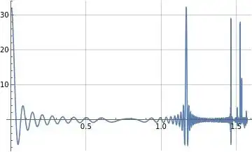

Figure (3) illustrates $\delta(f(t))$ using the Fourier series representation
$$\delta(t)=\frac{1}{2 \pi}\underset{N\to\infty}{\text{lim}}\left(\sum\limits_{n=-N}^N \exp(i n t)\right),\quad -\pi<t<\pi\tag{3}$$
evaluated at $N=100$ exhibits interference from the teeth of the Dirac comb. This answer I posted to a related follow-up question illustrates this interference more clearly.
delta(f(t)) using formula (3)
Figure (3): Illustration of $\delta(f(t))$ using formula (3) for $\delta(t)$

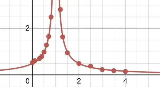

After more work, we get the actual solution where $y$ is the smallest positive solution to $\tan(y)-xy=0$
$$\int_0^\frac\pi2\delta(\tan(t)-xt)dt=\frac1{\sec^2(y)-x}+\color{green}{\frac1{2|x-1|}}$$
Therefore:
$$\frac1{\sec^2(y)-x}=\int_0^\frac\pi2\delta(\tan(t)-xt)dt-\frac1{2|x-1|}$$
Graphically, the $\color{green}{\text{error}}$ term works for $x\ge0$ and maybe $x\in\Bbb R$:
