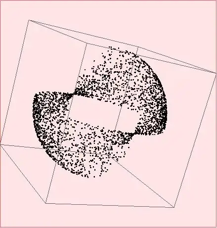

I was inspired by this question to play around a little bit (its a weekend). I was pretty confident of my derivation and thought it might be nice to supplement it with a pretty picture. However, instead of picking random points from the entire sphere the result I get are a bunch of random points from two opposite lunes. I've been scratching my head for an hour, and the only suspicion is that the distributions I have derived must be wrong (i.e not the code, I think). I am posting here what I would have hoped to be an answer.

Lune

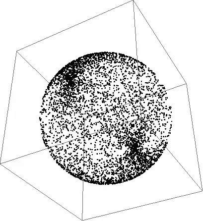

Mistake: Random variables should be equated to the CDF (probability) not the PDF. On integrating the PDFs to get the CDFs, the correct random variables are $$\theta = \cos^{-1}(2u-1)$$ $$\phi = 2\pi v$$
And the resulting plotenter image description here

I'm fairly certain that you're just missing a -1 inside the last ] of the first line. When I ran the code, I saw what you saw, but with a whole mess of errors about complex numbers where there shouldn't be any. Looking over your code, it seemed they must be coming from the ArcSin[], since it looks like you're taking the arcsine of numbers in the interval $[0,2]$ instead of $[-1,1]$. Hence, my thought about a -1, which for me seems to generate a more-covered sphere:
results
edit: Here's the code with the modification:
theta := ArcSin[2*RandomReal[UniformDistribution[{0, 1}]]-1 (* Here's the -1 *)];
phi := 2 Pi RandomReal[UniformDistribution[{0, 1}]];
plotPts = Table[{phi, theta}, {5000}];
cartesian[{theta_, phi_}] := {Sin[theta]*Cos[phi],
   Sin[theta]*Sin[phi], Cos[theta]};
cPts = cartesian /@ plotPts;
points = Graphics3D[Point /@ cPts];
Show[points]

  • @yayu: I actually hadn't thought much about this in terms of the original question. I suspect, from the looks of the 3d plot, that what you're generating is skewed toward the poles (or some poles), as the original question suggests can happen, rather than being uniform. – Isaac Jun 19 '11 at 05:40
