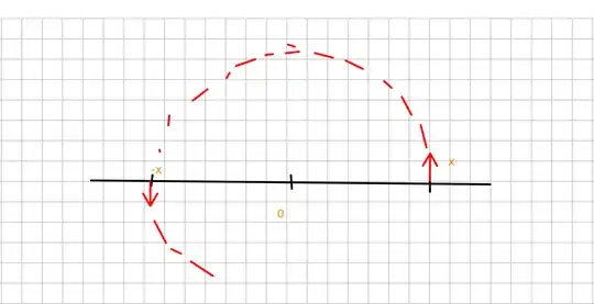

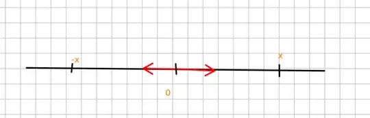

The main issue here should has to do with complex numbers. In a complex set up, every nonsingular matrix is the exponential of a matrix, so your particular real nonsingular matrix (and its powers) belongs to the flow generated by this complex matrix. There is a beautiful visualization of this fact. Consider a very simple discrete dynamical system: the points in $\mathbb{R}$ skipping from $x$ to $-x$ alternatively. That is, $n=1$ and $A=(-1)$ with your notation. If you want to "embed" this discrete dynamical system into a differentiable one, you need to go through 0 with two different velocities. So you need a second-order system (the harmonic oscillator, indeed). enter image description here
Or you can "extend the space", by considering complex numbers, and then you can embed this discrete dynamical system into a first order linear continuous dynamical system: $\dot{x}=i\cdot x$ enter image description here
Interestingly enough, in your setup, although it is not sure that $A^n$ can be embedded into a linear flow, it is the case for $A^{2n}$, because the matrix $A^2$ does have a logarithm (see here). So you can get a linear continuous dynamical system meeting your discrete system half the time. I think that this can also be related to the intuition given by the example above.
Indeed, I think that this example could answer partially the question. Because it should be easy to formalize that if you had a (possibly nonlinear) dynamical system such that $\phi(1,x)=-x$ and $\phi(2,x)=x$ then it cannot be an autonomous system, because of the two different velocities at $0$.

  • Thank you for your response! The way you put it, that A^2 can be included in a linear flow, and so can A if we work with complex numbers (with the accompanying pictures), is very clarifying. – Kiran Parkhe Jan 14 '23 at 02:49
