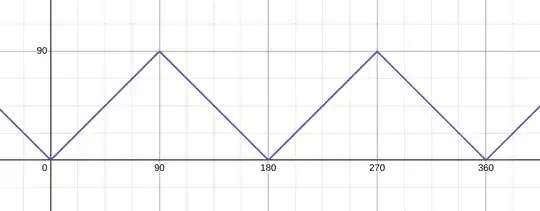

    It is the unsigned distance from a nearest multiple of $180$, i.e. the absolute value of the least magnitude remainder mod $180$, i.e. $,\delta' = |\delta \bmod_{\ell}! 180|,,$ where $\bmod_{\ell}!$ uses a balanced residue system (least magnitude remainders). – Bill Dubuque Dec 29 '22 at 09:33
Short answer: $$ \delta' = \bigl\lvert \operatorname{mod}(x - 90, 180) - 90 \bigr\rvert. $$ The graph of $\delta'$ as a function of $\delta$ is a triangle wave. (I'm assuming that this function is periodic every $360$ degrees, but you can restrict the domain to just $[0, 360]$ if you desire.)
Triangle wave.
Sammy Black
