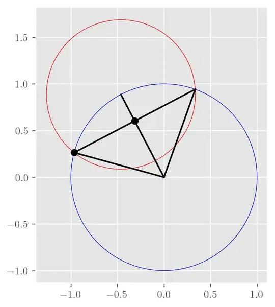

Let's place a sphere of radius $r$ at the origin and a smaller sphere of radius $\epsilon$ at $(0, 0, r)$ (i.e., on the intersection of the z-axis with the surface of the larger sphere).
We're interested in their intersection, so any points that jointly satisfy $$ x^2 + y^2 + z^2 = r^2, $$ and $$ x^2 + y^2 + (z-r)^2 = \epsilon^2. $$
I.e.: $$ z = r - \frac{\epsilon^2}{2r}, $$ and $$ x^2 = \epsilon^2 - \frac{\epsilon^4}{4r^2} - y^2. $$
Which suggests a way to sample points uniformly from the intersection: uniformly sample $y \in [-(\epsilon^2-\epsilon^4/4r^2), \epsilon^2 - \epsilon^4/4r^2]$, then compute the corresponding $x$ (sign given by a coin flip).
