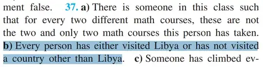

Please answer both questions that I listed at the end.
For question 37, B.

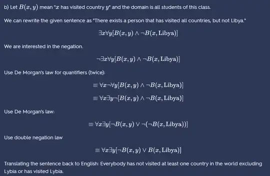

Then I went on to search for an answer on Quizlet, and this is what I found:
It seems that the difference is right at the beginning, they uses conjunction(∧) while I use implication(→). My questions are:
  • Why should we use "∧" and not "→" here?
  • If we use "∧", wouldn't the statement "∃x∀y((y≠Libya) ∧ P(x,y)" contradict itself since the domain of y include all countries. And by using conjunction, we assert that y is not Libya even tho Libya is one of them?

  • Thank you, that's very insightful but would you mind clearing this question up:
    If we use "∧" as shown in quizlet, wouldn't the statement "∃x∀y((y≠Libya) ∧ P(x,y)" contradict itself since the domain of y includes all countries? And by using conjunction, we assert that y is not Libya even tho Libya is one of them?
    – Chhangsreng P Dec 17 '22 at 13:12
    @ChhangsrengP Yes, it would contradict itself, and for just the reason that you have documented. The conjunction does imply that there is no country named Libya. So, the quizlet is wrong. My explanation is that the author of the solution made a mistake. Think about it in English. The author's interpretation is that "There exists a person that has visited all countries but not Libya". This implies that [1] The person has visited every country, and [2] The person has not visited Libya. The two implications do collectively imply that Libya does not exist. ...see next comment – user2661923 Dec 17 '22 at 15:18
    @ChhangsrengP What the author should have initially said was: "There exists a person that has visited all countries $~\color{red}{\text{except}}~$ Libya." This would imply that if Libya exists, then the person has not visited every country. Apparently, the author of the quizlet intended the interpretation in this comment, but instead mis-worded it, as per my previous comment. Then, once the English statement was misworded, the author of the quizlet then went off the rails. – user2661923 Dec 17 '22 at 15:22
