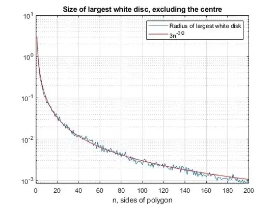

I have two graphs. They refer to white dots, which are small discs in the unit circle not crossed by any chord.
The first graph shows the size of the largest white dots, for each polygon up to 200 sides. It seems to match $3/n^{1.5}$ well, where $n$ is the number of sides of the polygon.

I took an array of points in polar coordinates, where $r$ ranged from $0.1$ to $1$ in steps of $0.0001$, and $\theta$ ranged in $100$ steps from $0$ to $2\pi/n$. That covers one wedge of the unit circle except for the centre of the circle; the calculations are periodic in theta. My first graph, above, shows that the grid is fine enough to land near the middle of the largest white dot. $r$ steps by $0.0001$, while the largest white dot has size at least $0.001$. For each array point, I calculated the minimum distance to any of the chords. The largest white dot is the array point where that minimum distance is greatest.

  • That is a very clever way to, in effect, measure the distance between the centre and the largest cell. In your second graph, for the higher values of $n$ there is no significant pattern, so I guess my conjecture is not true. But I do wonder why, for the lower values of $n$, there is that concentration around $r\approx 0.36$. – Dan Dec 04 '22 at 13:27
