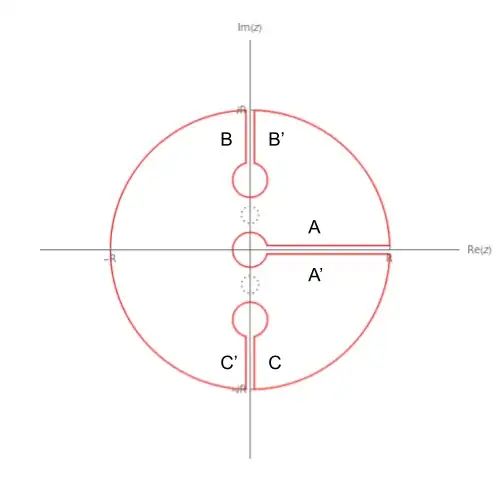

My attempt: Let $f(z) = \dfrac{\log^2(z) \arctan(z)}{a^2 + z^2}$ (where $\log^2(z) \equiv (\log(z))^2$) with $0<a<1$, and let
$$I(a) = \int_0^\infty \frac{\log(x) \arctan(x)}{a^2 + x^2} \, dx \quad .$$
Take $\mathcal C$ to be the same positively-oriented contour (redrawn here) with branch cuts along $[0,\infty)$ and $\pm[i,i\infty)$. The larger arc has radius $R>1$ and the smaller ones each have radii $\varepsilon$. The dotted circles indicate the poles at $z=\pm ia$.
I parameterized the banks to either side of the branch cuts (abusing notation) by
  • $A$ : $z = x+i\varepsilon$, $x\in[\varepsilon, R]$
  • $A'$ : $z = x - i\varepsilon$, $x\in[R,\varepsilon]$
  • $B$ : $z=-\varepsilon+ix$, $x\in[1+\varepsilon, R]$
  • $B'$ : $z=\varepsilon+ix$, $x\in[R,1+\varepsilon]$
  • $C$ : $z=\varepsilon-ix$, $x\in[1+\varepsilon, R]$
  • $C'$ : $z=-\varepsilon-ix$, $x\in[R,1+\varepsilon]$
As each bank approaches their respective branch cut, I believe we have
$$\begin{array}{c|ccc} A & f(x+i\varepsilon) & \to & \dfrac1{a^2+x^2} \log^2(x) \arctan(x) \\ A' & f(x - i\varepsilon) & \to & \dfrac1{a^2+x^2} \left(\log^2(x) + 4\pi i\log(x) - 4\pi^2\right) \arctan(x) \\ \hline B & f(-\varepsilon + ix) & \to & \dfrac1{a^2-x^2} \left(\log^2(x) + i\pi \log(x) - \dfrac{\pi^2}4\right) \left(-\dfrac i2 \log\left|\dfrac{1-x}{1+x}\right| - \dfrac\pi2\right) \\ B' & f(\varepsilon + ix) & \to & \dfrac1{a^2-x^2} \left(\log^2(x) + i\pi \log(x) - \dfrac{\pi^2}4\right) \left(-\dfrac i2 \log\left|\dfrac{1-x}{1+x}\right| + \dfrac\pi2\right) \\ \hline C & f(\varepsilon - ix) & \to & \dfrac1{a^2-x^2} \left(\log^2(x) - i\pi \log(x) - \dfrac{\pi^2}4\right) \left(-\dfrac i2 \log\left|\dfrac{1+x}{1-x}\right| + \dfrac\pi2\right) \\ C' & f(-\varepsilon - ix) & \to & \dfrac1{a^2-x^2} \left(\log^2(x) - i\pi \log(x) - \dfrac{\pi^2}4\right) \left(-\dfrac i2 \log\left|\dfrac{1+x}{1-x}\right| - \dfrac\pi2\right) \end{array}$$
I'm not sure that I fully grasp how to jump across branches so this might be where everything goes wrong.
Edit: The correction to make here (thanks to @Svyatoslav !) is along the banks $C$ and $C'$, for which we should have
$$C : f(\varepsilon - ix) \to \dfrac1{a^2-x^2} \left(\log^2(x)+\color{red}{3}i\pi\log(x)-\frac{\color{red}{9}\pi^2}4\right) \left(-\dfrac i2 \log\left|\dfrac{1+x}{1-x}\right| + \dfrac\pi2\right) \\ C' : f(-\varepsilon - ix) \to \dfrac1{a^2-x^2} \left(\log^2(x)+\color{red}{3}i\pi\log(x)-\frac{\color{red}{9}\pi^2}4\right) \left(-\dfrac i2 \log\left|\dfrac{1+x}{1-x}\right| - \dfrac\pi2\right)$$

  • Is it $\log$ or $\log^2$? – dfnu Nov 27 '22 at 09:48
    @dfnu It's $\log$ in the integral $I$, but I use $\log^2$ in $f(z)$ in the complex plane. It's a fairly well-known technique. See e.g. here – user170231 Nov 27 '22 at 10:00
    Just a quick observation which could help: $\log x$ is define by a cut along the positive part of axis $X$, and you go counterclockwise, making finally a full turn. At B, B' you get $\ln (xe^{\pi i/2})=\ln x+\pi i/2$; at C,C' $\ln (xe^{3\pi i/2})=\ln x+3\pi i/2$ – Svyatoslav Nov 27 '22 at 10:03
    Thanks @Svyatoslav , that seems to be exact what I was missing. My solution is still incorrect but I'm getting much closer :) – user170231 Nov 27 '22 at 21:15
After a bit of investigation, I found the last mistake in the evaluation of $K(1)$:
$$\begin{align*} K(a) &= \int_1^\infty \frac{\log^2(x)}{a^2-x^2} \, dx \\[1ex] &= -\frac1a \int_0^a \frac{\log^2(\frac xa)}{1 - x^2} \, dx \tag{1} \\[3ex] \implies K(1) &= -\int_0^1 \frac{\log^2(x)}{1-x^2} \, dx \\[1ex] &= - \sum_{n=0}^\infty \int_0^1 x^{2n} \log^2(x) \, dx \tag{2} \\[1ex] &= \sum_{n=0}^\infty \frac1{2n+1} \int_0^1 x^{2n} \log(x) \, dx \tag{3} \\[1ex] &= - \sum_{n=0}^\infty \frac{\color{red}2}{(2n+1)^2} \int_0^1 x^{2n} \, dx \tag{3} \\[1ex] &= - \sum_{n=0}^\infty \frac2{(2n+1)^3} \\ &= -\frac74 \zeta(3) \end{align*}$$
