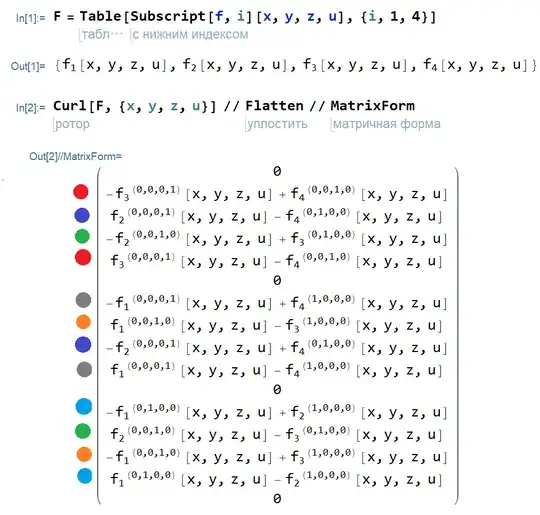

In the structure of the tensor, after $\text{Curl}$ is applied to a vector field $\textbf{F}$, there are (I don't know what to call them correctly) "symmetric" pairs of equations. This can help in solving a reduced-dimensional PDE system. Below - example for 4-dimensional vector field $\textbf{F}$. Circles mark symmetric pairs of equations.
